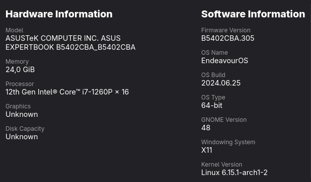

I have some problems launching my android emulators since few months with hardware acceleration enabled.
Previously I found that downgrading Mesa to version 24 make it work but since recent update, doing this prevent my system from booting.
So, for now, to be able to launch an android emulator, I need to use software acceleration. But it’s not a great solution as I need multiple emulators running at the same time and it consume a lot of resources.
One of my colleagues have the exact same issue on a different computer with EndeavourOs also.

what’s your hardware?
no GPU?
first thing I would try is wayland
Yes, no dedicated GPU, it is using the IGPU of the processor
Wayland doesn’t work great with screen sharing and other things like that, I have to much issue with it to consider this as a solution
One thing to note is that everything was working great with x11 and this exact installation few months ago
I tried with wayland it launch without issue… maybe I can try to solve my other issues with it instead of staying on x11, but if you have hints on how to make work again on x11, I’m in
