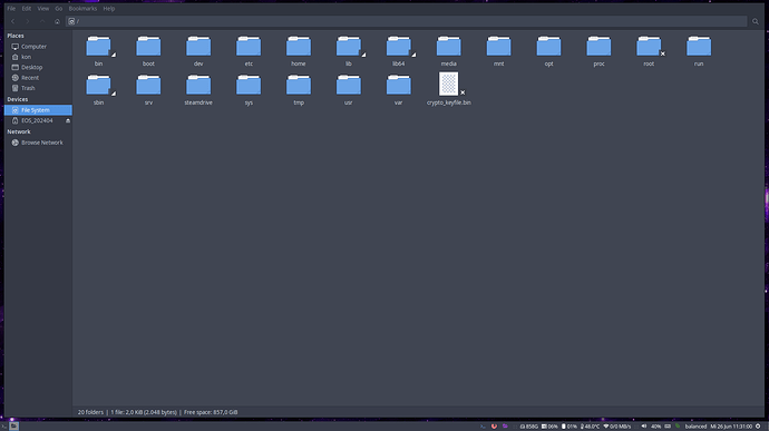

Here is a screenshot of thunar. You can see a thumbdrive being recognized. But the second drive doesn’t show up.
Also, e.g. in Steam I can not set the second drive as an installation location.
Does anyone know, how to fix this?
What happens if you mount the drive in your /home folder instead of mnt?
I suspect its not giving you permissions to to the device and permissions are set for root.
maybe instead of /mnt/external do /home/external
just noticed
LABEL=externaldrive /mnt/externaldrive ext4 defaults,user 0 2
I don’t think you need user for anything but NTFS.
I would run lsblk -f and get the UUID for the mounted device and mount using the UUID.
@thefrog That fixed the issue for me (mounting in ~/home and mount using UUID). Thank you so much!
