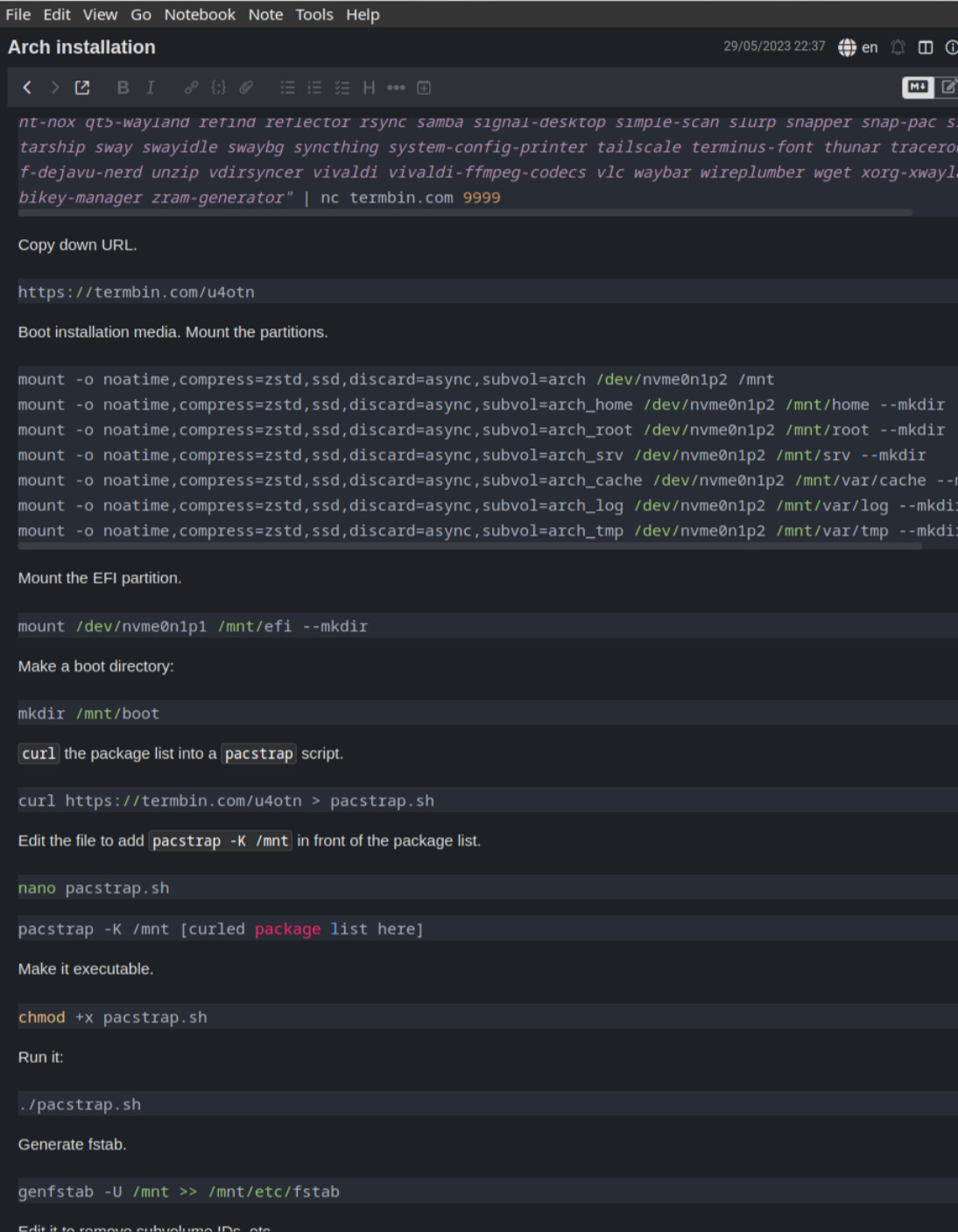

You may benefit from taking down some notes the next time you go through this process. I am the same way–I will spend a lot of time figuring out how to get something working the way I want, but the next time I am faced with setting it up I can’t remember crucial details and I have to research the process again.
Having some notes about how you set something up can make reproducing an installation a piece of cake. I can generally get a fresh Arch installation installed the way I like, with packages and configs and all, in about a half hour because I have all the needed steps outlined for myself in notes.
I have been using Joplin for a while to keep my notes organized and it works great, but even copying down notes in a .txt file is enough in some cases. For certain things, I have found good documentation can be more valuable than a backup.
