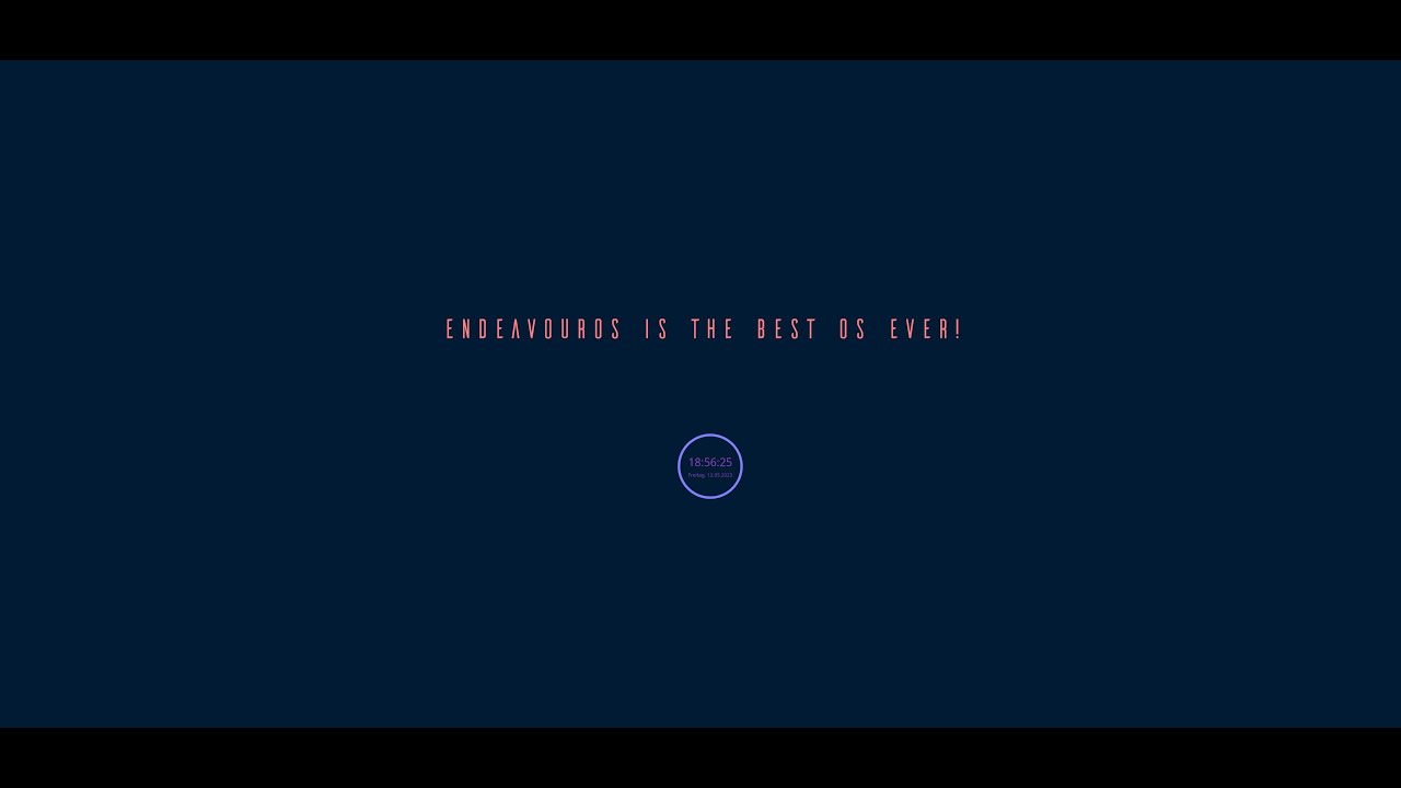

Freshly installed EndeavourOS
2
As you can see, there’s no visible transition on Debian. But for EndeavourOS there’s a very noticeable black-screen before the background loads.
Could it be related to what greeter that LightDM uses?
