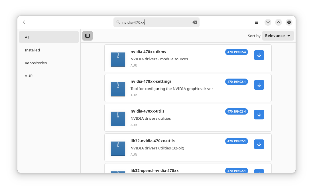

Edit: Okay i see you ran it. So you need to install the nvidia 470.xx version from the AUR
Not sure if you need the 32 bit library files.
yay -S nvidia-470xx-dkms nvidia-470xx-settings nvidia-470xx-utils
Command
nvidia-inst -t
should show the commands needed.
Note that there might be other requirements depending on your hardware.
Command
inxi -Gza
shows the graphics hardware.
