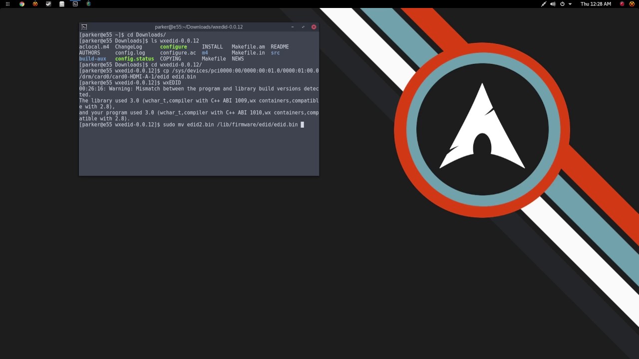

HOWEVER, I did finally find a solution! I ended up changing the pixelformat with a custom EDID. I very roughly followed this tutorial, some things varied for me:
This is, admittedly, a potential solution I found very early on. I just disregarded it because most of what I’d heard people describing happening to them with the wrong pixelformat was just crushed blacks and washed out colours, not something as extreme as everything being tinted green.
