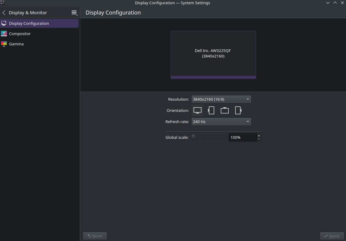

Thank you very much for helping me with this! It seems that it was indeed the Wayland session that was causing this, I notice that my display configuration options are much more limited within an X11 session, is this by design? There is also a significant decrease in the overall “smoothness” of the DE, moving windows around for example isnt as smooth, even with the selected 240hz option.
For example, VRR / no adaptive sync or screen tearing options, I do recall reading somewhere a while back that Wayland was much worse on Nvidia cards, and only as of late has it somewhat improved.
