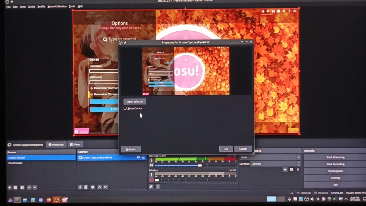

The issue I’m experiencing is that when I use OBS Studio to record using “Screen Capture (PipeWire)” as the resource and then choose windows for screen sharing and then choose fullscreen app that run on prime-run as the media I want to show on the canvas (in this case I choose game) then fullscreen app that i choose will freeze. However, everything works fine when I use the integrated graphics (not run the app or game using prime-run) or using Laptop Screen for the recording.
Screen Capture (PipeWire) > Open Selector > Windows > fullscreen app (prime-run) = Error.
Screen Capture (PipeWire) > Open Selector > Windows > fullscreen app (Integrated graphic) = Fine.
Screen Capture (PipeWire) > Open Selector > Screens > Laptop screen = Fine.

Bellow is provided video of what I just said since I believe my explanations are bad.
Sorry if I cant explain well enough. Thank you.
