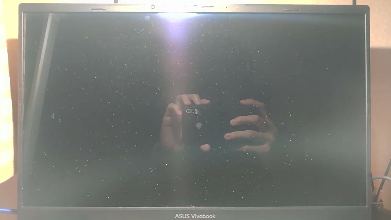

I’m a newbie to EndeavourOS and I’m using an ASUS Vivobook 15 Pro (12th gen) (K6502ZC) with an i7-12700H and an RTX 3050 Laptop. After I installed Hyprland and started using it, my screen started flickering. It only flickers when there are significant changes in the screen content.

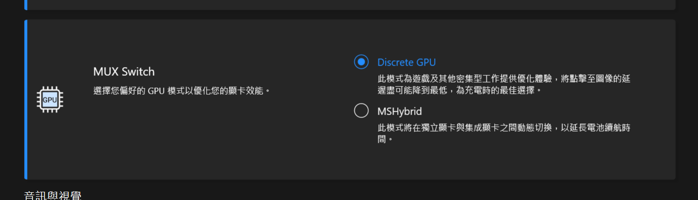

I have set the MUX Switch to Discrete GPU mode using the MyASUS software.

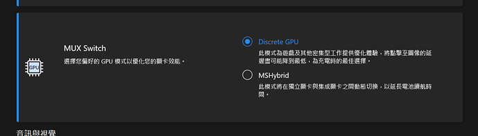

I followed these steps, but if I configure Hyprland to use my dGPU for rendering while in MSHybrid mode in the MyASUS app, I only get a black screen. Using Discrete GPU mode makes no difference; the flickering persists.
To anyone who stumbles upon this problem, I’m not sure if it was just me, but my display doesn’t work well with Variable Refresh Rate. When I disabled it in Hyprland, the problem went away. There is information here (https://wiki.hyprland.org/Configuring/Monitors/) on how to disable vrr. Hopefully this helps someone.
