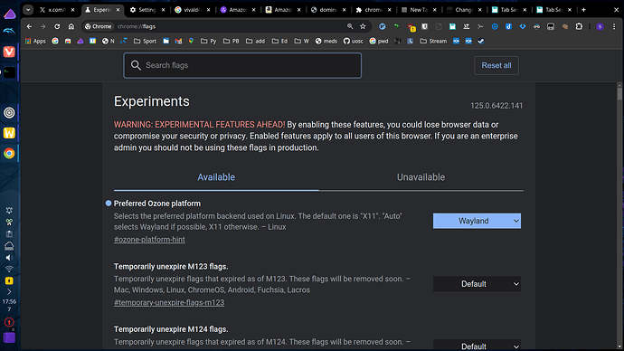

Your desktop session is using Wayland. This flickering is a known issue with Nvidia cards and will hopefully be resolved in an upcoming driver release.
Log-out, and log-in again using X11, instead of Wayland, and the flickering should hopefully go away. Once the Nvidia 555 drivers are release, hopefully this issue will be no more.
I run on an RTX3070, no flickering.
On chrome/chromium/electron based browers and apps, edit the desktop file and add:
--enable-features=UseOzonePlatform --ozone-platform=wayland
To the exec line, e.g.:
Exec=opera-beta --enable-features=UseOzonePlatform --ozone-platform=wayland %U
You can also set the flags in some browsers:
This is google chrome.
