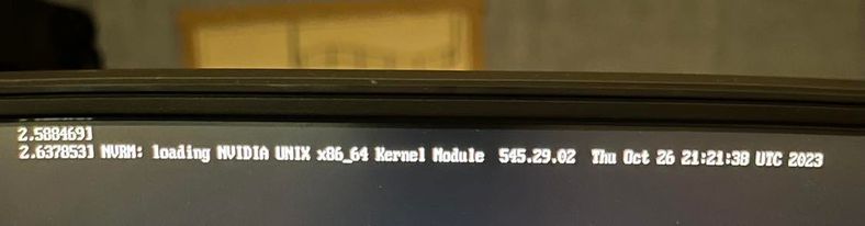

When I restart the computer, there are some red fields on my splash screen, but it goes so fast that I can’t read it.
But I have used journalctl and below are the errors I can find.

Normally, when waking the system from hibernation, it only displays [2.588469]. However, since the update, it now shows two entries:
[2.588469]
[2.637853] NVRM: loading NVIDIA UNIX x86_64 Kernel Module 545.29.02 Thu Oct 26 21:21:38 UTC 2023
I’ve attached a photo to illustrate this.
I wonder if the system might have entered some sort of hibernation loop. After updating, I forgot to restart the computer and instead put it into hibernation. That’s when the additional line appeared, and I also
began experiencing issues with the screen brightness.
I believe the numbers are meant to indicate how much swap memory has been utilized for hibernation.
