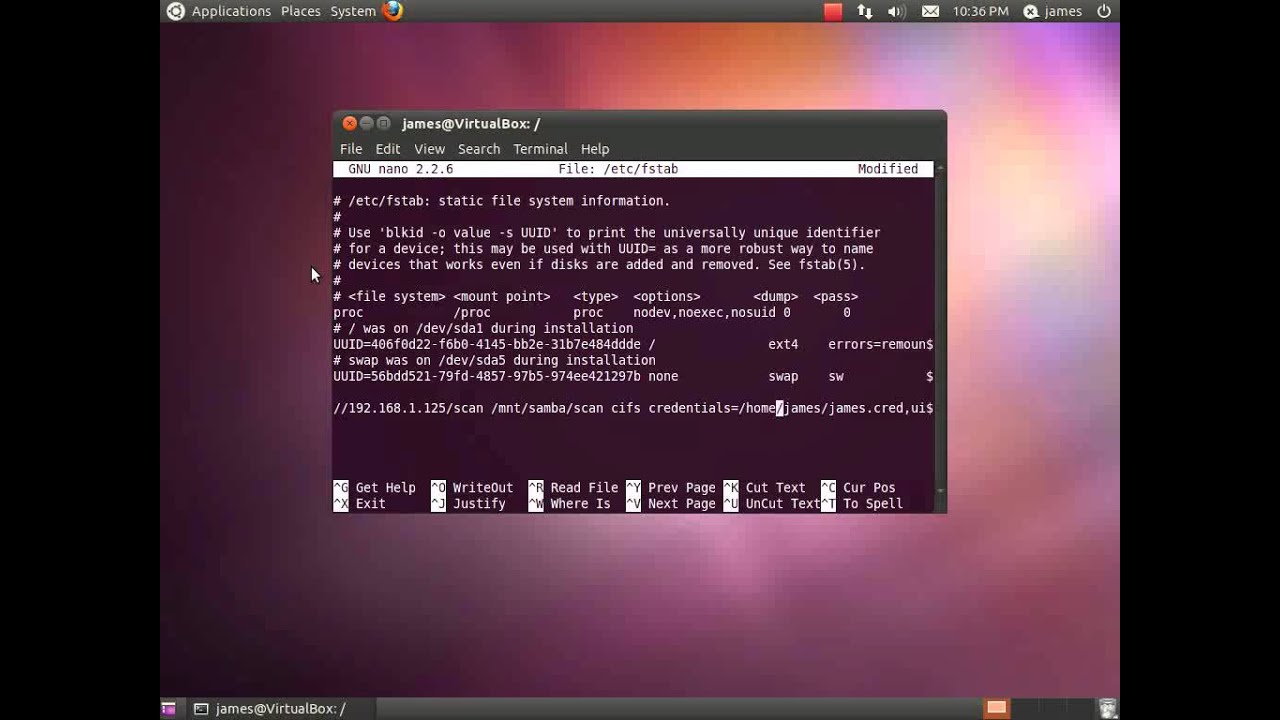

Check out this video its for Ubuntu but works just fine on most arch based system
gvfs updates finally solved it for me
