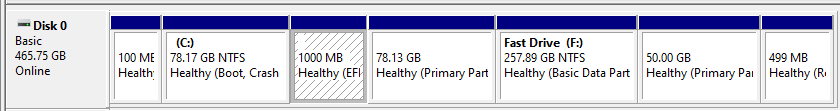

Sorry for the Windows screenshot, I’m currently dual booted into Windows for work. But running out of space on Windows partition, so it’s kind of urgent!
This is a 500gb nvme SSD partitioned as follows;
  • Windows boot partition,
  • Windows System partition,
  • Linux boot partition,
  • Linux system partition,
  • and a couple other storage partitions.
I want to grow the Windows system partition (the 2nd one) to give it more room. I would shrink the “Fast drive” partition to do this. (Using Gparted in a live boot)
This would cause my 2 Linux boot and system partitions (the 3rd and 4th ones) to be shifted down.
I’ve killed my dual boot before with something like this, but I think I was moving / restoring partitions. But this time I would simply be sliding / shifting the Linux boot & system partitions down. Could this potentially ruin the dual boot that Endeavour OS has set up?

What you have in mind entails the following steps in practice:
  1. Shrinking the (F) drive (NTFS, best to be done from within Windows). You will now have some unallocated space to the right of the (F) drive.
  2. Move (F) drive to right.
  3. Move EnOS’ system partition to the right.
  4. Move EnOS’ ESP to the right.
  5. Now you will have that unallocated space to the right of your Windows partition. Resize the partition to the right to fill up the unallocated space.

Thanks man. What you described is exactly what I’d do - I was just wondering if the “sliding” of a partition would cause problems, like, does a boot menu refer to the exact byte position on the drive or is it higher level than that, and it just refers to the partition by its name and there should be no issue with this?
