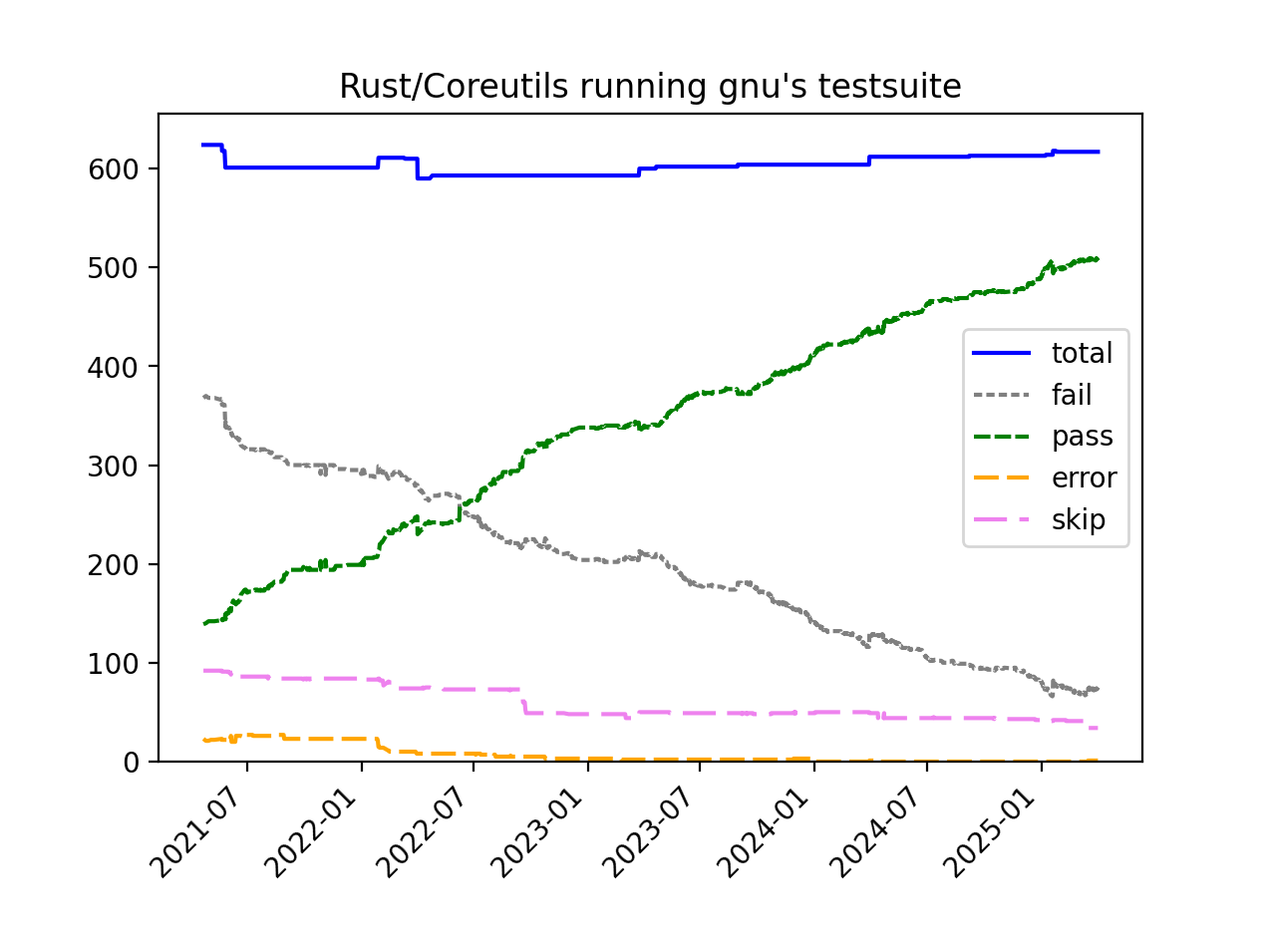

One really should be aware of the circumstance that uutils-coreutils is an ongoing effort which isn’t completed yet.
Thus, for the actual state of progress, there is this overview of the test against the GNU coreutils test suite. Which lists all of the results and current errors / fails.
This graphic summarizes the actual progress:
I’m not aware of their roadmap, but it seems like it may take them more than just a few months to implement the rest of the features to replace GNUs Coreutils.
