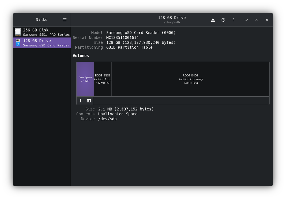

It is not necessary to format anything on your target RPi micro SD, or USB 3 SSD. Formatting is part of the image.
Simply download the image, use gnome-disk-uitility to restore disk image to burn the image to your RPi 4b storage device. Of course there are other image burners, but I have been using gnome-disk-utility on both GTK and QT Desktops for decades with no problems.
In gnome-disk-utility your burned image should look like this
The default for disk format is ext4. If you want btrfs, you have to create your own image.
Not as difficult as it seems. See here:
Pudge

Now all of a sudden you are saying " The problem is the GPT table", and “you are not understanding the problem and are confusing formatting with partitioning”?
So I guess “** I haven’t made myself clear**” is the appropriate statement.
Pudge
In my previous post I said…
I never mentioned anything about filesystem formatting, nor is it mentioned anywhere in the thread until you brought it up in your reply.
So I was actually quite clear about what seems to be the problem. Perhaps you didn’t read carefully what I wrote, but it does seem you confused formatting with partitioning.
If my wording came across as offensive in any way (English is not my first language), please accept my apologies. I truly appreciate your help, and my only intention is to figure out where or what exactly is going wrong.
With that out of the way, let’s cut to the chase and focus on the real issue.
Thanks for pointing me to the script. I can now conclusively state that the issue I’m facing is due to GPT partitioning. To test it, I simply burned the image using:
xz -d -c enosLinuxARM-rpi-latest.img.xz | sudo dd bs=4M status=progress of=/dev/sda
As mentioned earlier, my RPi 4B won’t boot. However, if I run the following script:
#!/bin/bash
DEVICENAME=/dev/sda
DEVICESIZE=8192
parted --script -a minimal $DEVICENAME \
    mklabel msdos \
    unit MiB \
    mkpart primary fat32 2MiB 514MiB \
    mkpart primary 514MiB ${DEVICESIZE}MiB \
    quit
–which is essentially the same script you use for partitioning, but with MBR/DOS instead–then my RPi 4B boots normally and I can complete the EOS setup.
From what I’ve read across several pages, the EEPROM bootloader didn’t support GPT until around 2020(?). I’ve also read that GPT is only supported by the bootloader when booting from USB… strange. Anyway, I guess the best way to proceed is to update the EEPROM.
UPDATE: I’ve updated the EEPROM and now my RPi successfully boots from GPT… from both, SD and USB!
Now, looking closely at the _partition_RPi4() function you referred to, it’s clear that it was originally designed for msdos partition tables. In fact, the function is flawed. The primary keyword is reserved for msdos partition tables, so parted interprets it twice as a partition name when used with GPT. Also, since the unit command is used, specifying MiB in the subsequent lines is no longer necessary. I would recommend to choose between using unit or being explicit. Finally, instead of using quotes for concatenation (which should be reserved for escaping and such), it’s better to use braces: ${DEVICESIZE}MiB.
My bad. It has been so long ago that I updated the EEPROM that it never entered my mind. I assume you know about rpi4-eeprom in the Archlinux ARM repos.
With the latest EEPROM version, GPT works fine on a micro SD card. When I create fresh images, I burn the images to a micro SD and do test installs before releasing them on github.
When it comes to coding, I am at best a hobbyist. Never had any formal training or coded professionally. So I am sure the scripts could use some cleaning up. But they serve their purpose.
Pudge
I’ve spent so many hours on this and the solution was so close at hand! Well, let’s continue :smiley:
