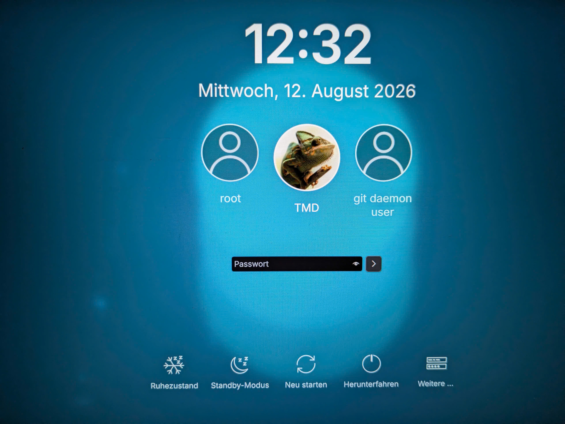

Has anyone encountered a problem as shown in the pic and is there a fix for it? The two “accounts” appeared after a sudden shutdown during a package update.
Cheers, D

Have never experienced this, what where you updating, how where you updating?
Hi, unfortunately I couldn’t remember what packages were being installed (it was via -Syu), but I read somewhere that some installations may create these accounts or something (I have to check)
I’m not too sure where to go then from here, others might know more but I don’t think I ever installed anything that makes its own account ever
Right, thanks anyway, I’ll look further then
Yer sorry I couldn’t help more, hopefully someone a bit more knowledgeable can chime in
Check
sudo grep -E 'root|git' /etc/passwd
Seems shell is wrongly changed for root and others
Sorry to ask but can you explain this a bit more, I never had anything do this and want to know why it occurs.

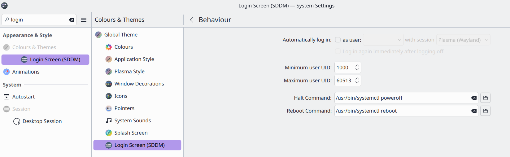

In KDE Plasma 6.6.x or higher go to the System Settings. And navigate to Appearance & Style > Login Screen > Behaviour and change the value of Minimum user UID to 1000. See the screenshot given below for more details. This is for SDDM, but something similar will be there for Plasma Login Manager, aka PLM too. Cant say about other Display Managers though.
Reboot the system and the user should no longer be visible.

A system crash/shutdown during an update is a pretty chaotic event, and one can presume that recreating these groups was one of the things that the system needed to do to recover.
git daemon user is perfectly normal, it’s created and used by the git package (which is required by yay, which is shipped by default with Endeavouros).
Stagger_Lee>> getent passwd | grep git
git:x:977:977:git daemon user:/:/usr/bin/git-shell
The only issue with these users (root and git daemon user) is that they should not be showing as entries on the login screen.
Have you run an update (and rebooted) since the system shutdown during an update?
