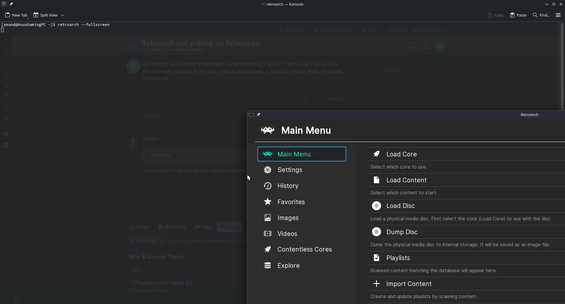

Hi! Trying to use retroarch at fullscreen, but both pressing F and F11 don’t work. This works on the appimage, however. Every time it tries to go fullscreen, I just get a window where my mouse is contained.
--fullscreen
you can add this to your launch command to make it launch in fullscreen
So I ran the command, and then took this screenshot showing my issue.
Right after I copied the screenshot, it went fullscreen! Only thing though was that I couldn’t F11 out of fullscreen, which you definitely could in the past.

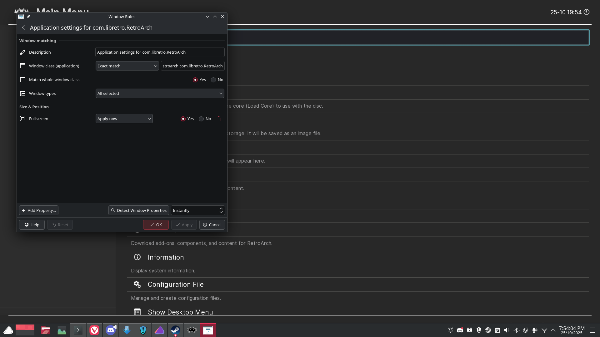

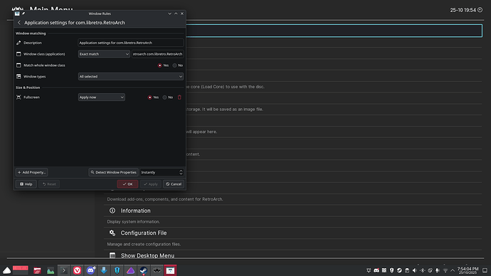

So I was able to make it fullscreen through an application setting rule on the Plasma side, but every time I try with the fullscreen method in retro arch I keep getting the same action of it just making the cursor the fullscreen cursor or it moves the window. Attached is a screenshot of what I had to do as a workaround.
