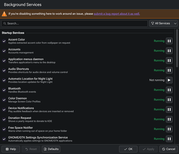

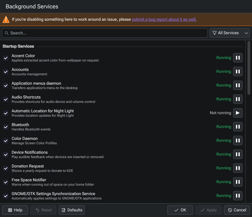

Disabling unnecessary services is a reasonable step. It’s something I’ve been doing on installs for years, in the past under Windows, and now under Linux.
I have manually specified my location for night light, I don’t need automatic location updates for it.
I don’t use any bluetooth devices, so the Bluetooth service is superfluous.
I can turn off the yearly donation request service
I don’t need my device LEDs to syncronise with Plasma’s accent colour.
I don’t use the Firefox Flatpak so I don’t need a service that provides support for it.
I don’t want Plasma browser integration, let alone a reminder.
I don’t use a proxy, so the verifier is unnecessary.
I prefer not to have removable devices auto-mounted.
My NAS uses SFTP, not SMB, so I can disable the SMB watcher.
My desktop has no touchpad, so I don’t need that.
That’s my use case, others may choose entirely different things.
It may not free up loads of RAM, but it very simply stops things from running and consuming resources that are entirely unnecessary.
