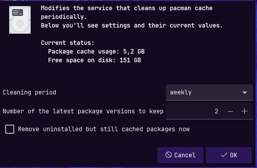

Thanks for this tip, very useful. Quick question: I was wondering why the default answer for cleaning cache directory (/var/cache/pacman/pkg/) is “no”. If I understand correctly, the cache files are only used if a (specific version of a) package needs to be re-installed and are not needed when programs run normally, so deleting them should have no impact on performance. Only on how fast a package can be re-installed. If I have a fast connection but am running low on disk space, those cache files aren’t really worth keeping, right?
Thanks.
3000yl
not really or not always… yes but just in case… something break your network drivers? Could be useful to be able to downgrade packages and deps…

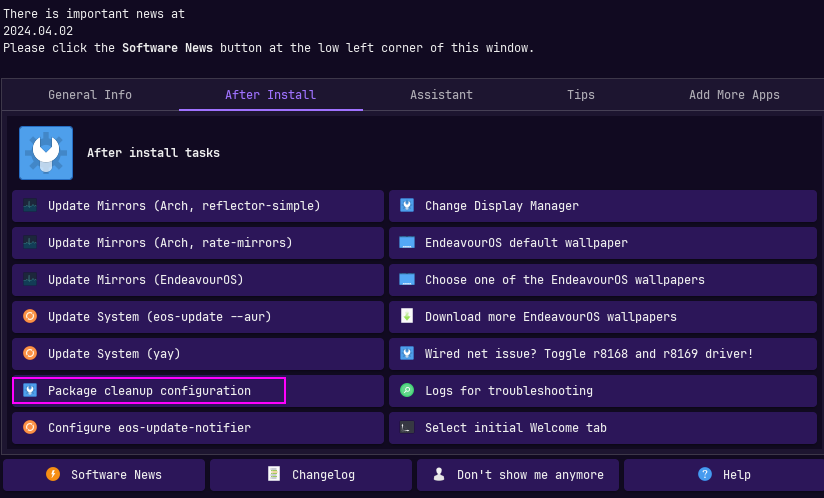

And there is:
2024-04-04_09-19
Yay is only holding sources and PKGBUILDS from formerly installed and installed AUR builds itself…
And yea the ~/.cache/yay/ files can get removed… it will simply redownload them on updates what can take more time.
Package backups are stored by pacman in its cache path.
