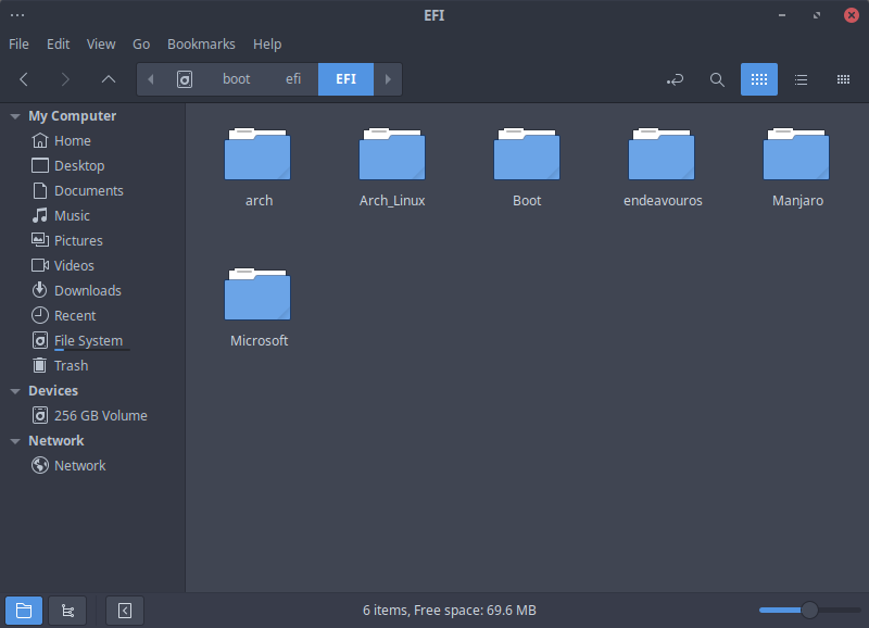

So here’s something i can’t understand either. On my Cinnamon dual boot Win 11 I reinstalled grub after the updated grub package and ran the grub update command. This is what it did to the path and this didn’t happen exactly the same on the other 4? So it added folders for arch, Arch_Linux, endeavouros, Manjaro, and Microsoft. What the hell? On my other Lenovo it added even more stuff. Is it because of the way i installed grub? I installed it to the efi partition on all of my systems. They all work but this is just strange.

[ricklinux@eos-cinn ~]$ efibootmgr
BootCurrent: 0001
Timeout: 0 seconds
BootOrder: 0001,0005,0004,0000,0007,0003,000C,9999,0002
Boot0000* Windows Boot Manager	HD(1,GPT,e8e61be8-2572-45f8-9b53-984aac714ba1,0x800,0x32000)/File(\EFI\Microsoft\Boot\bootmgfw.efi)57494e444f5753000100000088000000780000004200430044004f0042004a004500430054003d007b00390064006500610038003600320063002d0035006300640064002d0034006500370030002d0061006300630031002d006600330032006200330034003400640034003700390035007d00000000000100000010000000040000007fff0400
Boot0001* endeavouros	HD(1,GPT,e8e61be8-2572-45f8-9b53-984aac714ba1,0x800,0x32000)/File(\EFI\endeavouros\grubx64.efi)
Boot0002  Linux Boot Manager	HD(1,GPT,b6f3f68c-d7e5-4421-87a9-44f4548c3238,0x800,0xff801)/File(\EFI\systemd\systemd-bootx64.efi)
Boot0003* rEFInd Boot Manager	HD(1,GPT,d1930251-4caf-4b74-b76d-a56cdc7e616d,0x800,0x32000)/File(\EFI\refind\refind_x64.efi)
Boot0004* arch	HD(1,GPT,e8e61be8-2572-45f8-9b53-984aac714ba1,0x800,0x32000)/File(\EFI\arch\grubx64.efi)
Boot0005* Manjaro	HD(1,GPT,e8e61be8-2572-45f8-9b53-984aac714ba1,0x800,0x32000)/File(\EFI\Manjaro\grubx64.efi)
Boot0007* Linux Boot Manager	HD(1,GPT,3c448293-9673-4f92-a602-11ddac197204,0x800,0x1f4000)/File(\EFI\systemd\systemd-bootx64.efi)
Boot000C* Internal Hard Disk	PciRoot(0x0)/Pci(0x2,0x4)/Pci(0x0,0x0)/NVMe(0x1,8C-E3-8E-04-01-12-60-54)/HD(1,GPT,e8e61be8-2572-45f8-9b53-984aac714ba1,0x800,0x32000)0000424f
Boot9999* USB Drive (UEFI)	PciRoot(0x0)/Pci(0x1d,0x0)/USB(16,0)0000424f

  1. Delete folders that include bootloaders for systems they no longer exist
  2. Delete the UEFI entries that point to files that do not exist (after previous clean-up).
  3. Confirm the preferred bootloader is first in UEFI entries (efibootmgr)
