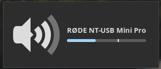

The issue I still have is that volume up/down buttons stopped working. They try to change the microphone audio sound even though it’s not active (the HDMI sink is “running”):
Screenshot from 2022-06-27 22-47-03
