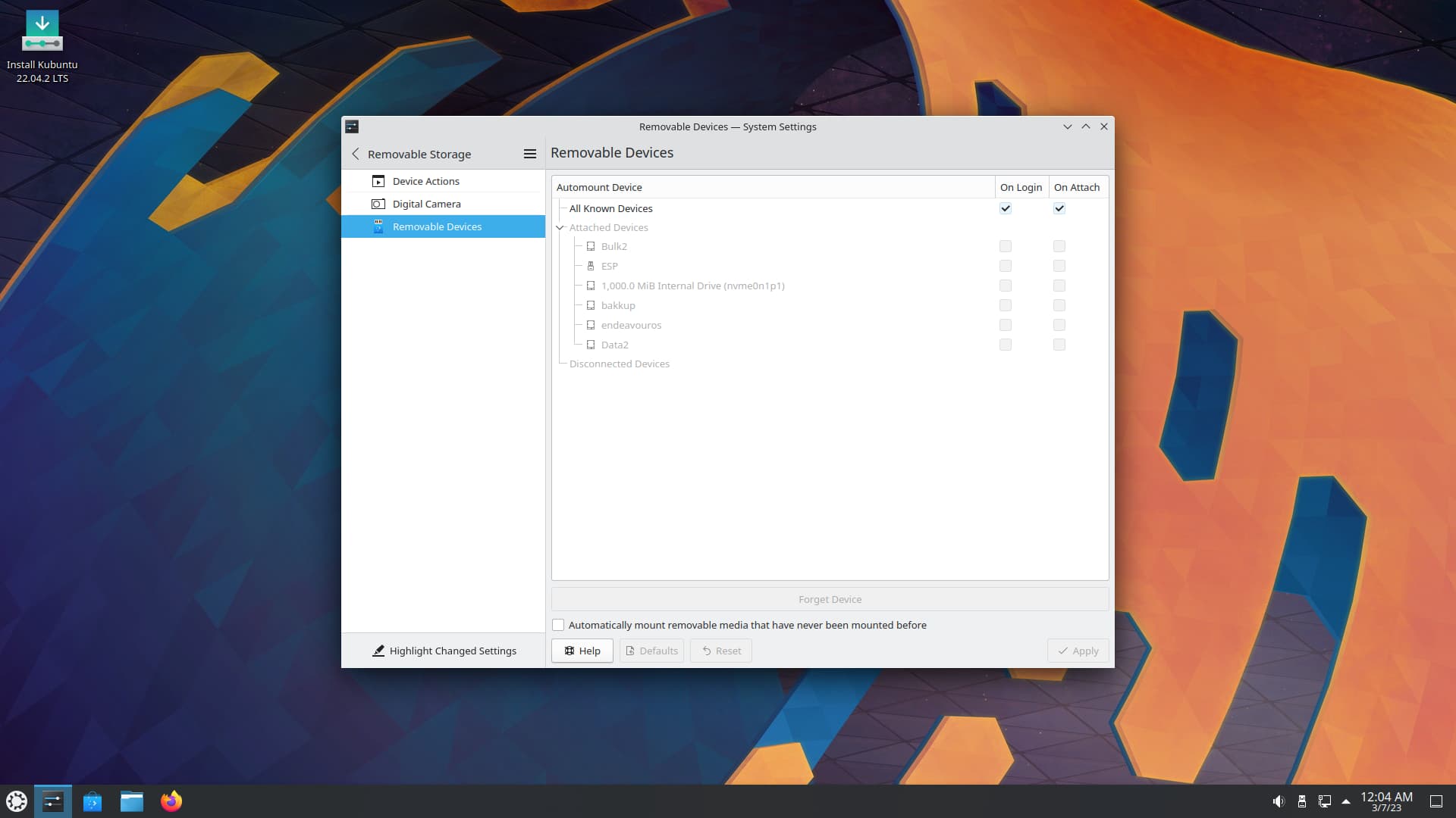

I attached a USB drive and I still can’t get anything to appear on that list, something is amiss here.
I flashed a Manjaro (Plasma 5.26) and a Kubuntu (Plasma 5.24) live USB for testing. In Manjaro the list looks the same, but in Kubuntu it lists everything I have attached, even non-removable devices.
This is how I used it before, it’s an easy GUI way of adding fstab entries I suppose.
I tried again with a different USB device and it appears, I guess I had to tick a box to automount for it to show up? I don’t even know.
Edit: Everything appears now. I have no idea what triggered it, but it seems to have happened after I ticked the checkbox to attach all known devices and rebooted.
I am so confused, but I guess it’s fixed now.
