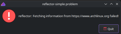

I used to be able to update just fine but now reflector simple is not working and because of that i can not update the mirror list for it or update its packages.
If I try I see this screen.

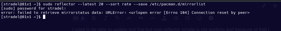

And if I try from the command line it says this:

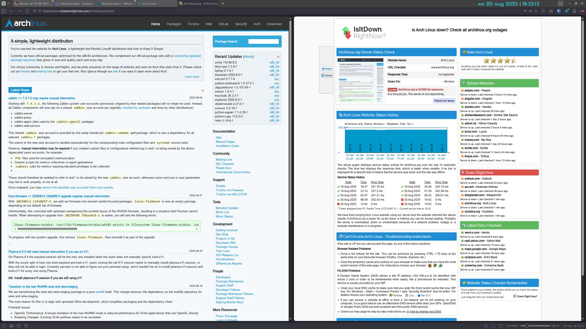

Looks like the the Arch site is unavailable and that affects mirror ranking tools like
  • reflector
  • rate-mirrors
  • reflector-simple (a wrapper around reflector)
and probably others too.
See https://status.archlinux.org/

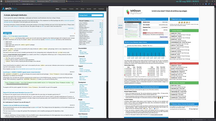

This is really weird:
The website is intermittently down, or sometimes loading slowly. Sometimes very slowly.
i managed to update yesterday, it were normal then.
You can update right now. The outages at archlinux.org do not affect mirrors. Mirrors are independent of the archlinux.org website.
Ranking mirrors with reflector (or refelctor-simple), however, may fail, as they retrieve the latest mirrorlist at archlinux.org/mirrors/status/. If that website is down or times out, reflector will fail.
