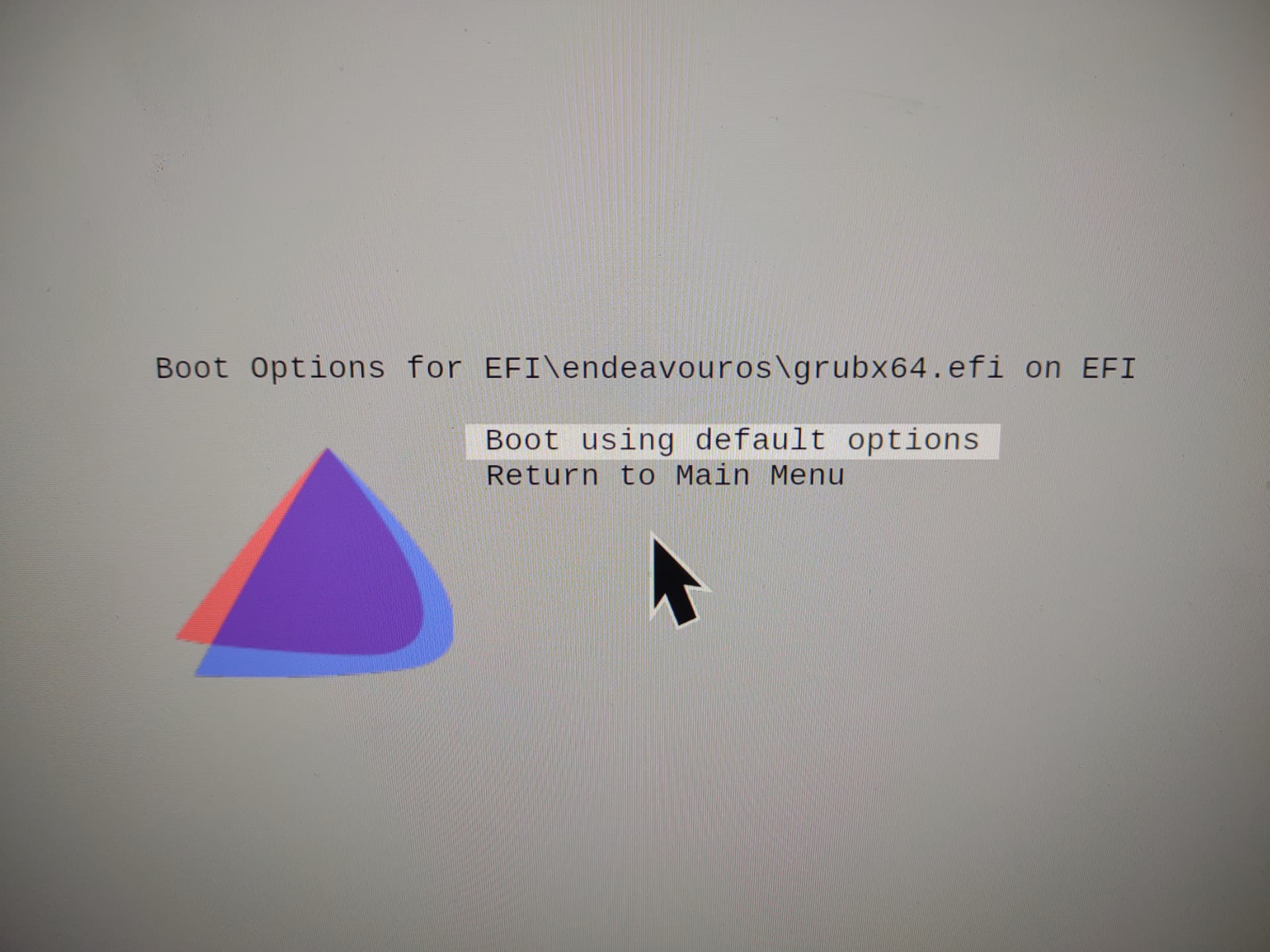

I followed the specific guidance found in the link you provided (i.e.,un-commenting the “fold” feature and ensuring it is set to false), but upon rebooting the only choice that appeared in the EndeavourOS category was the same a single option and even delving into the sub-choices within EndeavourOS (which presumably would have already been “un-folded” and appearing on the top level) was this …

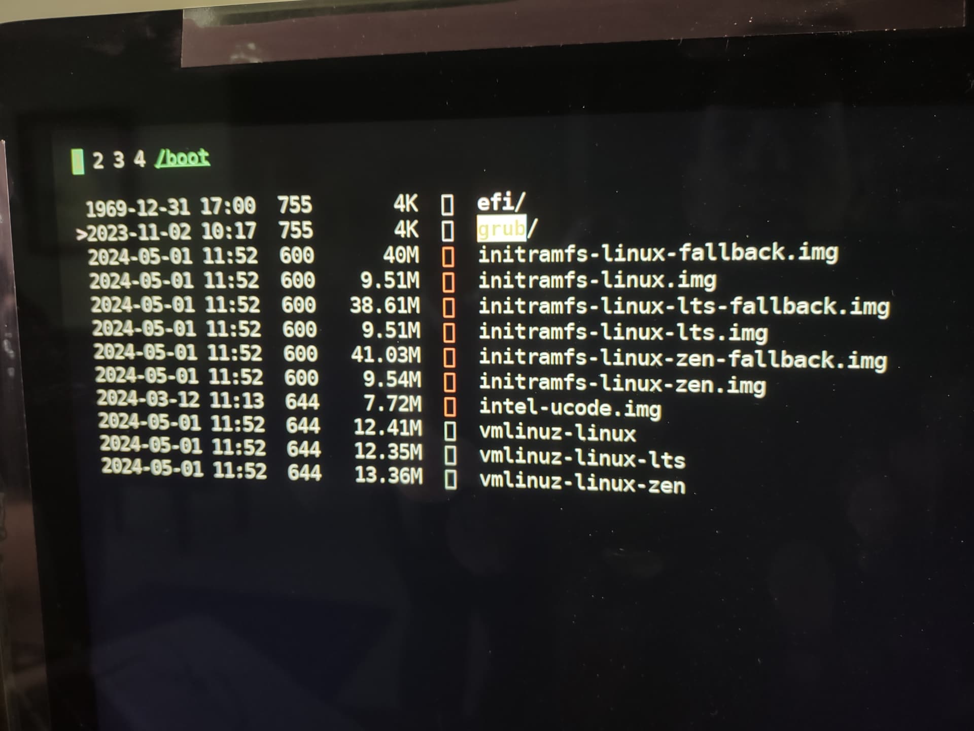

FWIW, I’ve confirmed the location of my various kernels are all here …
… so maybe I need to move certain of these files out of my /boot directory and into a sub directory, perhaps /boot/efi/EFI/endeavouros/ :thinking:
Did you press F2?
If you hit F2 or Insert, you’ll see options for all the other kernels. (If refind_linux.conf has more than one line, each kernel will have multiple entries, one for each line in refind_linux.conf.)
I know this doesn’t show them by default, but I’d like to know if pressing it shows them all.
PS: In Grub, the kernel choices are also “folded”, so I’d think this is the default behaviour even in rEFInd where you’d need to do some extra step to see them. Is it that your Grub (when you used to use it) showed all the kernels without needing to press anything?
@anon93652015 Yes I did hit F2, which (as I just reconfirmed) is how I get that first screen image shown above).

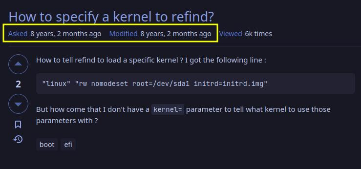

It’s possible that you can’t find that file because things have changed over the last 8 years. :wink:
Also (arch wiki):
After installing rEFInd’s files to the ESP, verify that rEFInd has created refind_linux.conf containing kernel parameters in the same directory as your kernel.
It seems it should be in the same directory as your kernel.

UPDATE: Noting that all those other kernels are residing directly in my /boot directory, I just added also_scan_dirs boot to the refind.conf file and FINALLY… a whole bunch of additional boot-up choices are found after hitting F2. This is meaningful progress!
Unfortunately they’re offered in cryptic hexadecimal labels (likely, partition IDs?) so I’ve got to do some work to get them to be more human-recognizable.
