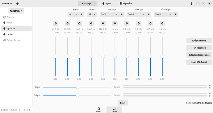

Well i use easyeffect for balance setting to compensate for my hearing loss on one ear. But you can use the “equalizer” plug in to reduce the bass.
The sliders from left to right are the audio spectrum from bass to treble. So the sliders on the left are the ones you need to “lower”. I would start with the first one and then go the second if that wasn’t enough for you.
PS: You can increase the number of bands and “fine tune” (confine the reduction to more specific freq intervals) if you want to.
