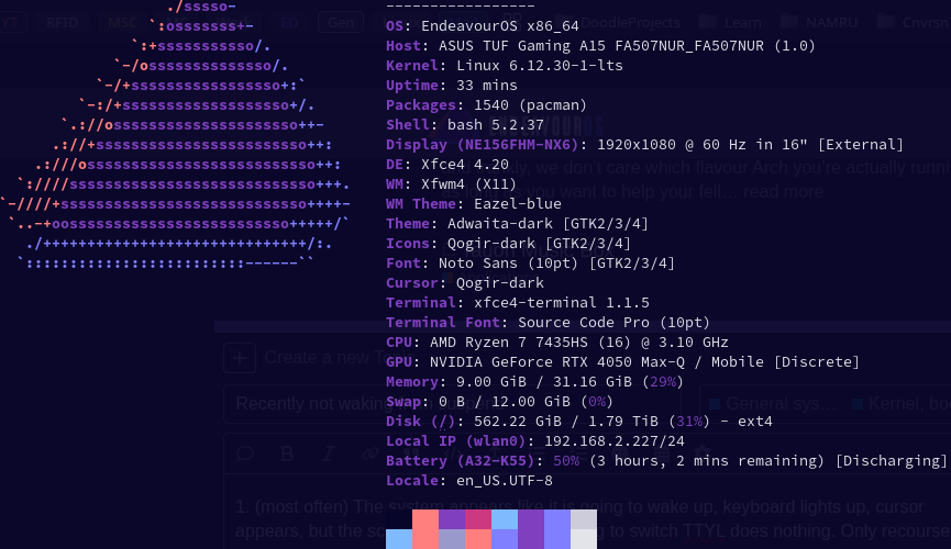

I’m running on an ASUS TUF A15-FA507NUR laptop. As I said, suspend has been working just fine until very recently. Now, completely randomly, when it goes into suspend I get a couple of possible outcomes.

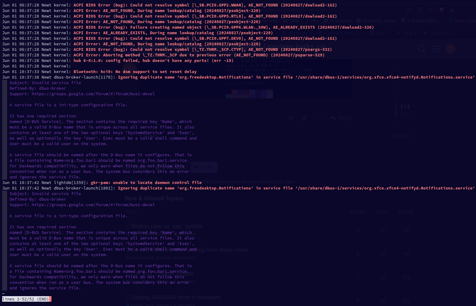

I’m not sure what all info/logs will help, but I’ll start with this

Also adding this from journalctl, the system woke up just fine this morning and then had problems hours later.
$ journalctl --since today --grep=suspend

Yes, I’ve had the latest BIOS (303 in this case) since I bought the laptop.
I have not tried the later kernel as there was a notice I read somewhere about instability being caused by utilizing more than one kernel so I’ve just kept with 6.12. Which was working prior anyhow and was/is the only kernel I have been using daily so I don’t see how that could be the problem.
Today I did a system update and it bumped my 6.12.32lts up to 6.12.33lts and my secondary kernel went from 6.14 to 6.15. I’m still concerned about that dual use kernel problem as I haven’t had time to really investigate it.
