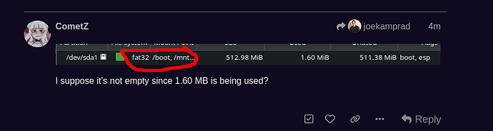

I suppose it’s not empty since 1.60 MB is being used?
thats systemd-boot and as you see /efi is the mountpoint for the efi partition.
You can redo the mount and chroot…

looks good now you had it mounted to /boot before
