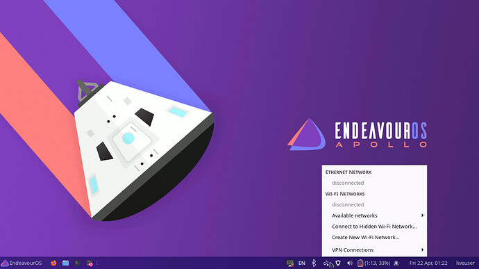

OK, I don’t know what you’re clicking on, or not.
The Network Manager icon works perfectly for me, even with no networks available.
Normally I’d suspect that you have made some customisations to EnOS somewhere along the line…
Could you verify whether this icon works correctly within a live installer environment?

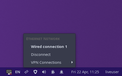

I logged in as liveuser again to make sure if I get the same result like in your picture.
Jbn4fb7
It doesn’t look like in your picture even when I’m using EnOS as liveuser.
Exactly. I don’t understand why it works for @jonathon when he is using EnOS as liveuser. I had the same issue with Atlantis Neo but back then we fixed it somehow.
The icon is working with a pop-up menu, however. The wifi won’t show up - as expected - because the driver isn’t installed in the live installation environment.
The question now is why this menu does not appear for your normal user.
