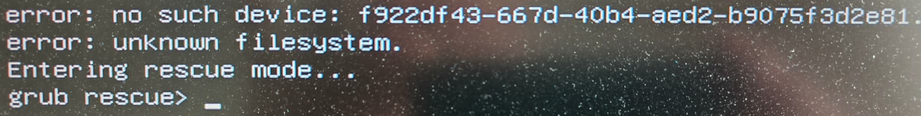

Sometimes it works fine and sometime I have this error :
error: no such device: b508d6f6-6135-4831-b1bf-3520a30f3008.
error: unknown filesystem.
grub rescue>

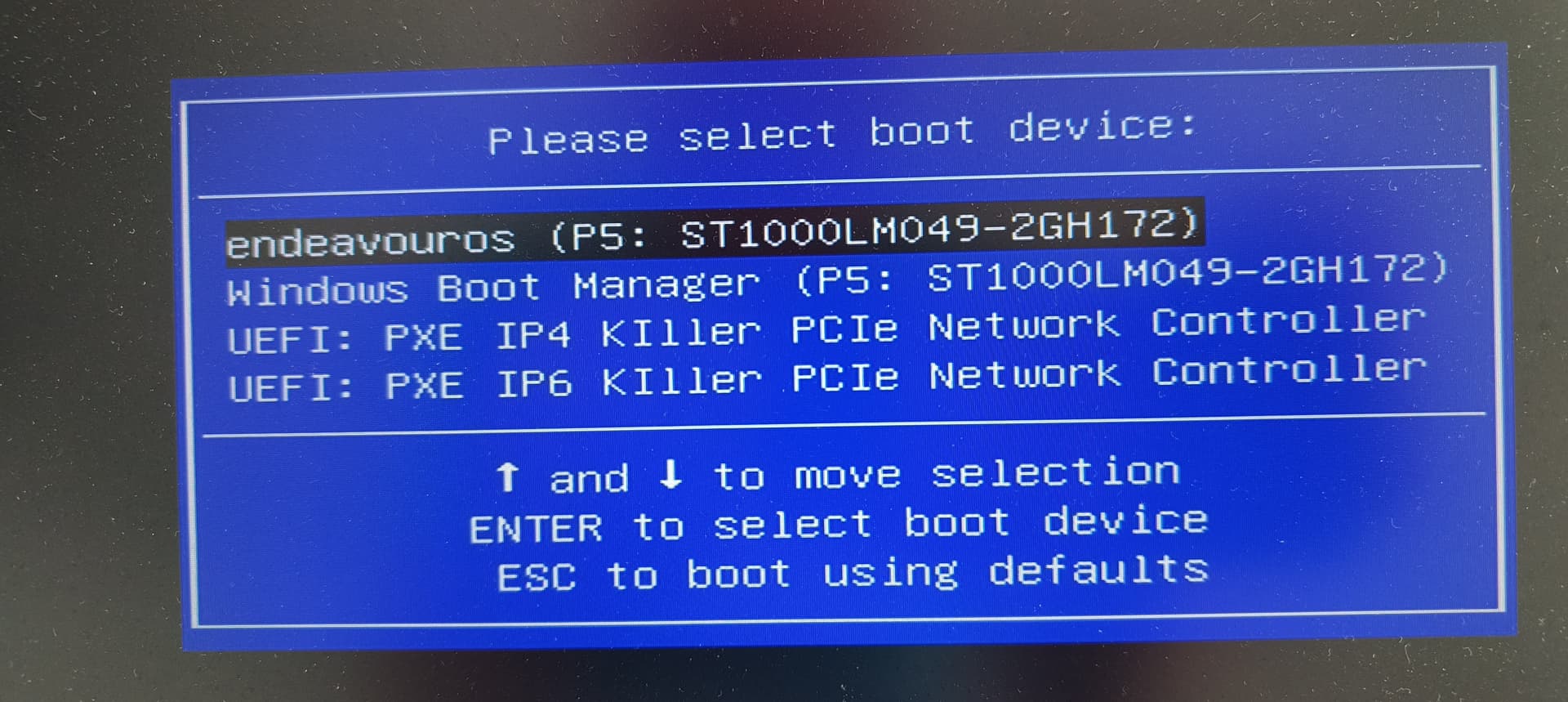

I have found a workaround, I use F11 on my MSI laptop and then I can select my boot device as EndeavorOS an then everything works fine.

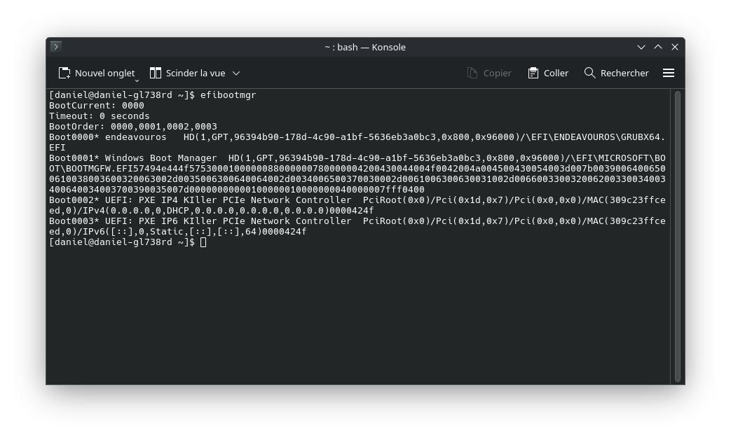

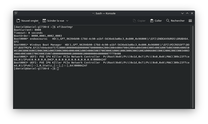

[daniel@daniel-gl738rd ~]$ efibootmgr
BootCurrent: 0004
Timeout: 2 seconds
BootOrder: 0004,0007,0000,0002,0003,0001
Boot0000* boot HD(1,GPT,96394b90-178d-4c90-a1bf-5636eb3a0bc3,0x800,0x96000)/\EFI\BOOT\GRUBX64.EFI
Boot0001 grub HD(1,GPT,96394b90-178d-4c90-a1bf-5636eb3a0bc3,0x800,0x96000)/\EFI\GRUB\GRUBX64.EFI
Boot0002* UEFI: PXE IP4 KIller PCIe Network Controller PciRoot(0x0)/Pci(0x1d,0x7)/Pci(0x0,0x0)/MAC(309c23ffceed,0)/IPv4(0.0.0.0,0,DHCP,0.0.0.0,0.0.0.0,0.0.0.0)0000424f
Boot0003* UEFI: PXE IP6 KIller PCIe Network Controller PciRoot(0x0)/Pci(0x1d,0x7)/Pci(0x0,0x0)/MAC(309c23ffceed,0)/IPv6([::],0,Static,[::],[::],64)0000424f
Boot0004* endeavouros HD(1,GPT,96394b90-178d-4c90-a1bf-5636eb3a0bc3,0x800,0x96000)/\EFI\ENDEAVOUROS\GRUBX64.EFI
Boot0007* Windows Boot Manager HD(1,GPT,96394b90-178d-4c90-a1bf-5636eb3a0bc3,0x800,0x96000)/\EFI\MICROSOFT\BOOT\BOOTMGFW.EFI57494e444f5753000100000088000000780000004200430044004f0042004a004500430054003d007b00390064006500610038003600320063002d0035006300640064002d0034006500370030002d0061006300630031002d006600330032006200330034003400640034003700390035007d00000000000100000010000000040000007fff0400

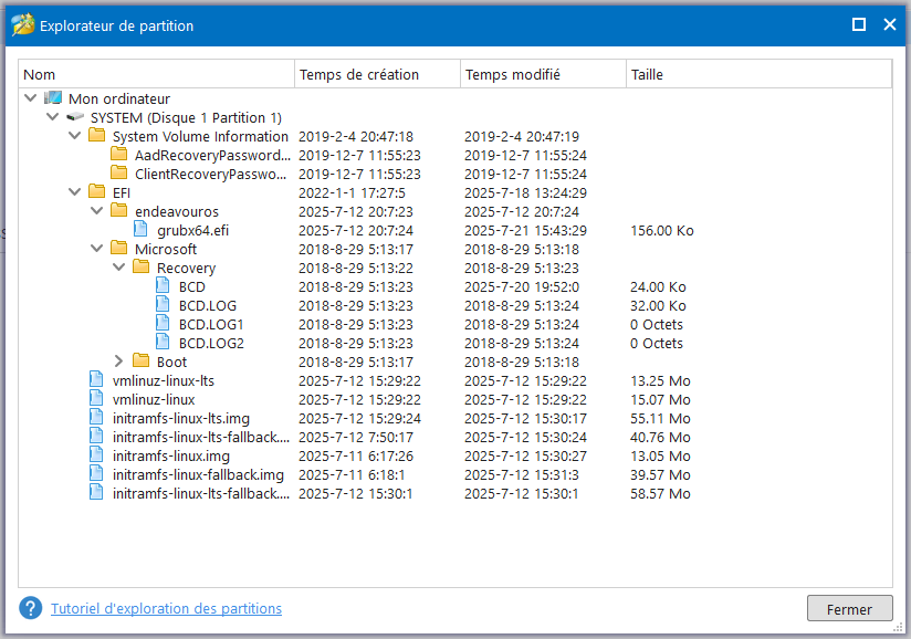

Not by far being a expert on this I noticed that your efi partion is 96% full.
That seems a bit to much for good measure, also I noticed you have grub 3 times , that seems a bit strange too.

The 300Mo came with the original efi partition with Windows7 when I bought this laptop.
I have installed EndeavourOS in replacement of an old arch installation.
It seems that during the grub installation, EndeavourOS created a new grub without replacing or updating the previous one.
Well it makes sense that eos would have created a new grub , because it uses a different path then the other two grub files. You could delete the other 2 grub files if they are not in use and free up some space. If I can make a suggestion , and it is not to much of aproblem, you could reinstall Eos and create a new EFI partition ,using the installer , so your efi parttition wil use the nvme, which probably also speed up things a little bit at boot.

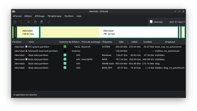

the size for /boot/efi is too small ( around 100M to 300M )
Yes I know but there is a “Microsoft reserved partition” just behind which is not movable.
