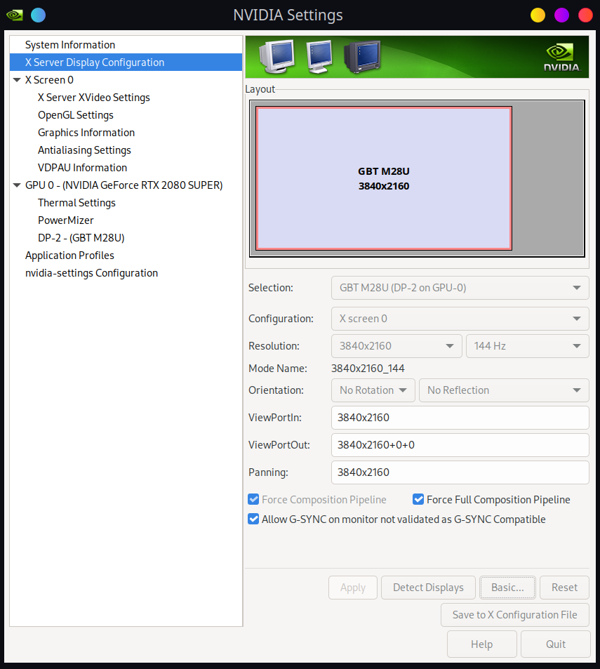

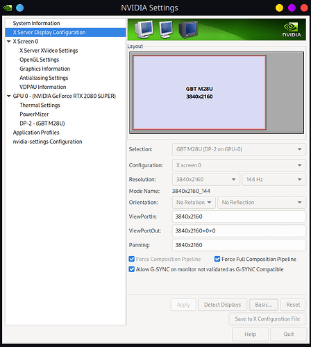

I am using KDE as my DE and as for my monitor it is only one, a Gigabyte M28U set to 4k and 144hz, my GPU is an RTX 2080 SUPER. I am also using the Display Port with the cable that came with the monitor. The issue persists no matter what ports I am using.

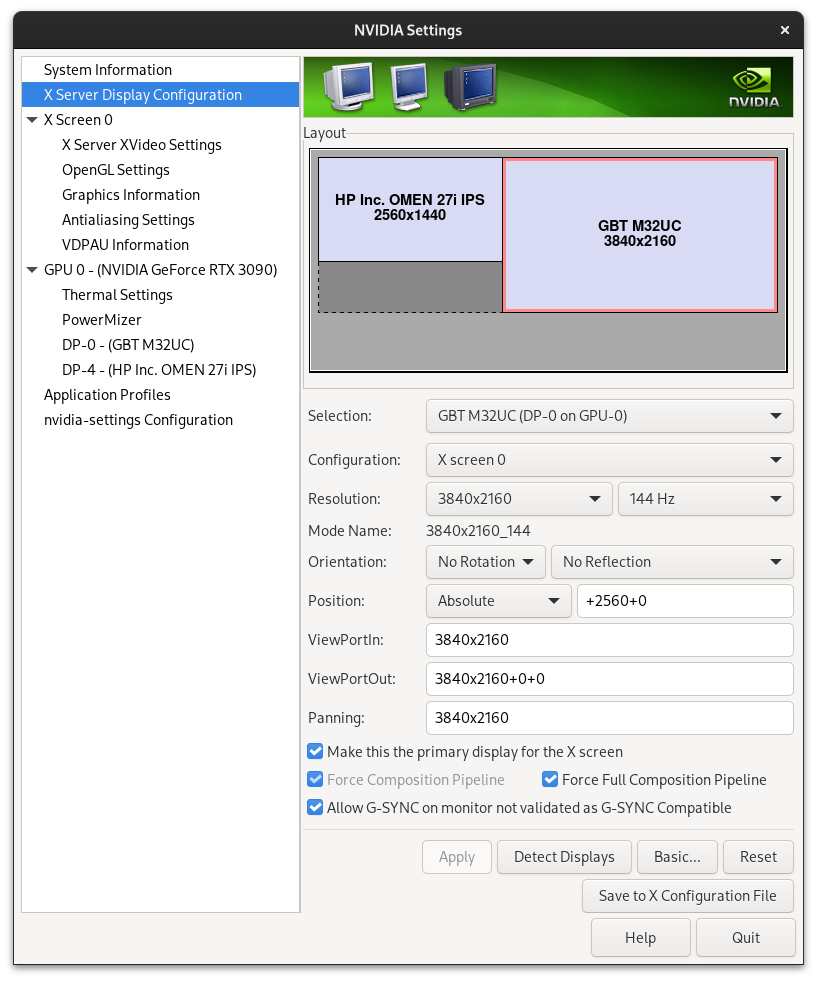

I have read in more places people running into this issue, I always enable “Force Full Composition Pipeline” and “Allow G-Sync” on monitor not validated as G-Sync compatible" if you don’t already have than enabled.
What Nvidia packages do you have installed and kernel, probably the EndeavourOS default but it might be worth trying a different nvidia packages and maybe a different kernel as well?
To be honest I have never heard about the option Force Composition Pipeline or the Full Force Composition Pipeline, I can see online that their purpose is to prevent screen tearing which sounds like it may help. Are there any disadvantages in using it? I will try enabling those 2 setting and see how it goes.
It was also hidden in the Advanced section and I completely missed its existence :sweat_smile:

And you could also try turning off “Allow G-Sync” on monitor not validated as G-Sync compatible", to see if that changes anything.
Thanks for the info, it really helps, I am going to try to play around with the Composition Pipeline first to see if this works and if it doesn’t I will try using the nvidia-lts package
Yesterday I have turned on only the Force Composition Pipeline and while the issue still persisted, it happened way less often. Today I am trying to use it paired with the Force Full Composition Pipeline to see how it goes, after a reboot I already noticed something nice, using these options also fixed my issue of not being able to re-scale the resolution in the grub boot menu, it only happened after the DE was done loading up.
I have been using the Force Full Composition Pipeline for around 2 hours now and the issue seems to have disappeared. The GPU usage and power draw went up a small bit, but I don’t mind. Will test more and see how it goes.
Edit: The problem seems to have fully gone away by turning on the Force Full Composition Pipeline, many thanks for the help.
