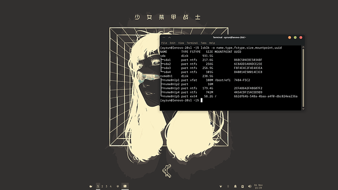

If you share the output of lsblk -o name,type,fstype,size,mountpoint,uuid I can share some specific commands when I have time in a bit.

There is a 100 GB unallocated space in the sda disk which i created using the windows disk management application.
Start by using gparted or kde partition manager to create an ext4 partition in the unpartitioned space.
Then again run the command from above.
Please don’t post text output as a screenshot. Please paste it directly into the forum in a code block.

Also, i have formatted the unallocated space to ext4 using gparted application. What’s next?
