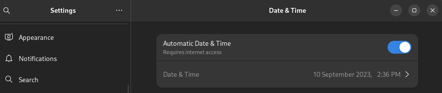

Out of curiosity, how are you testing this?
This is the toggle in Gnome Settings I am toggling after I enable Chrony:
So after this is done the “systemd-timedated.service” is restarted automatically and it switches to using systemd-timesyncd.service.

I am wondering how you verify that “the system will switch back to using systemd-timedate.service
I check both the chronyd.service (becomes disabled after the toggle)

@dalto I have also captured this information after I did a cold boot or a restart. Once I
  • enable chrony.service
  • disabled systemd-timesyncd.service
it will keep these settings (so far). But when I toggle on\off in Gnome Settings then the system will switch back to using systemd-timesyncd.service.
Guess my playing always find something to puzzle me. Below are the terminal messages with the time line intact after a cold boot:
