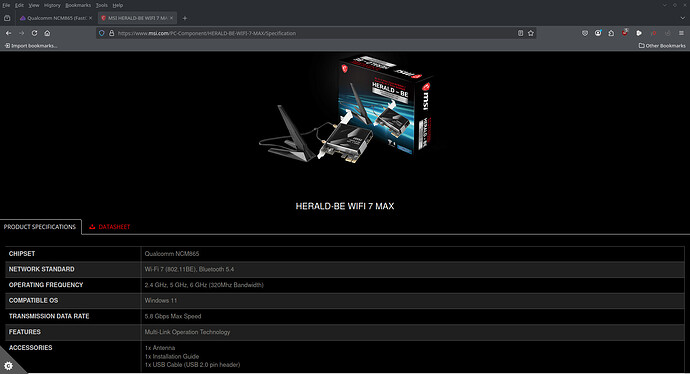

@robert-tech
It looks like a nice adapter and I’m a MSI fan but i don’t like it when it say’s compatible OS Windows.
Edit: I try to pick hardware that reports compatible with linux also when it comes to some of these adapters and other parts.
Edit: Maybe it’s just not there yet with the drivers and firmware?
