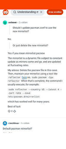

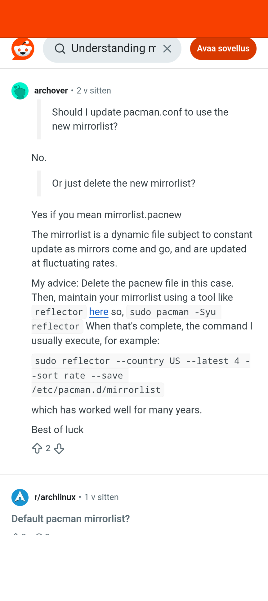

Is this true?
Of course we are talking about in sense of EOS. So if you use reflector etc. in EOS Hello -app, is there need for going through .pacnew (mirror list in this case) file or is it safe to delete?
Because this is something I have to admit been battling inside since I first used Arch and have never been able to find concrete solution or peace of mind on question am I doing it correctly?
And which files that you absolutely have to go through? Is there consensus on that?
I’m referring especially to this answer:
