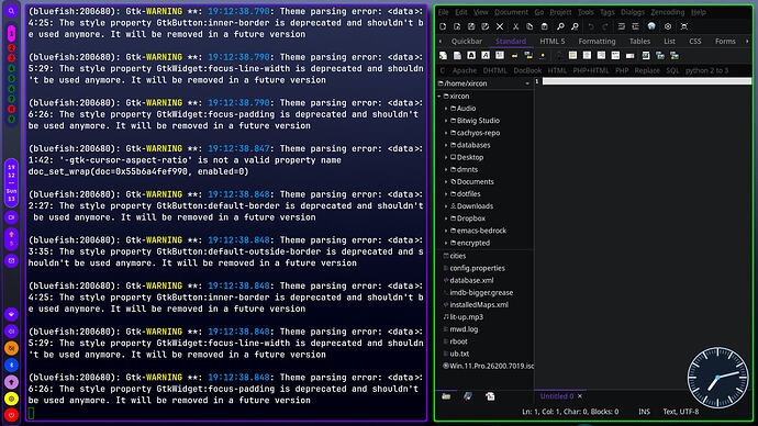

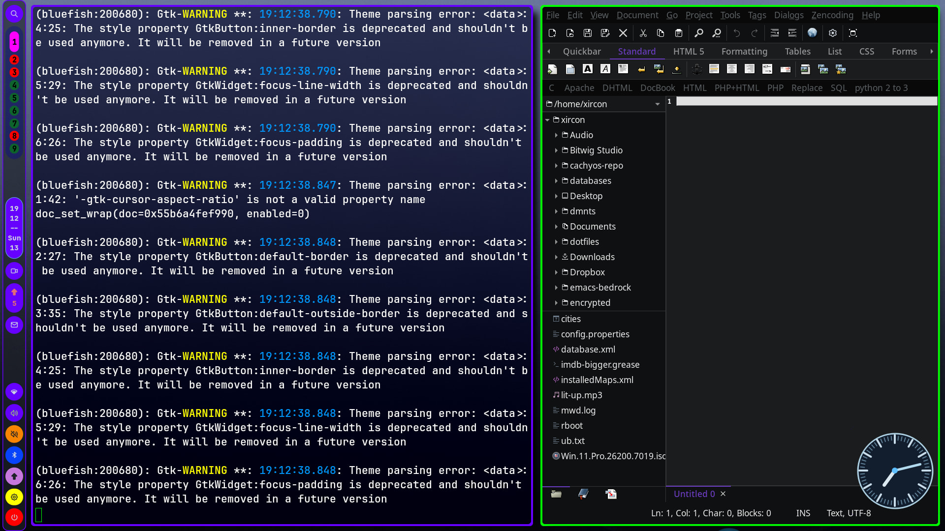

bluefish is not installed. I just installed it and if it was installed it would run by typing bluefish…
sudo pacman -S bluefish
It appears that bluefish was installed as a flatpak. You use the flatpak run command to launch flatpaks from terminal.
You should be able to launch it from the terminal with:
flatpak run nl.openoffice.bluefish
Don’t do this as root.
