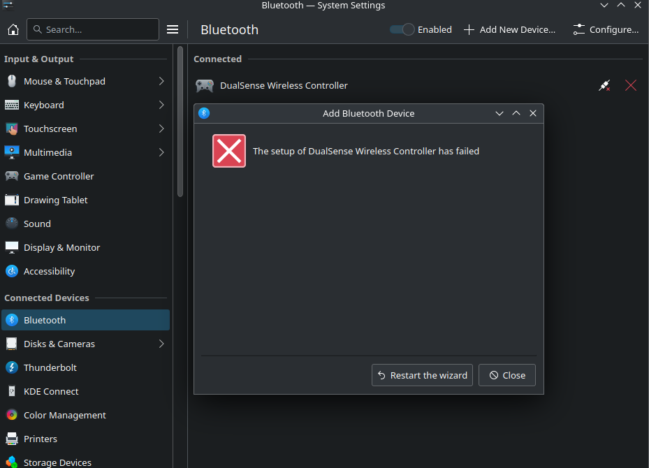

I get the following error when I try to connect it, but the controller “seems” to be connected, has can be seen in the background of the screenshot and on the controller.
The controller indicates it is “connected”, but is not recognized by either Steam or EOS as a Game Controller.

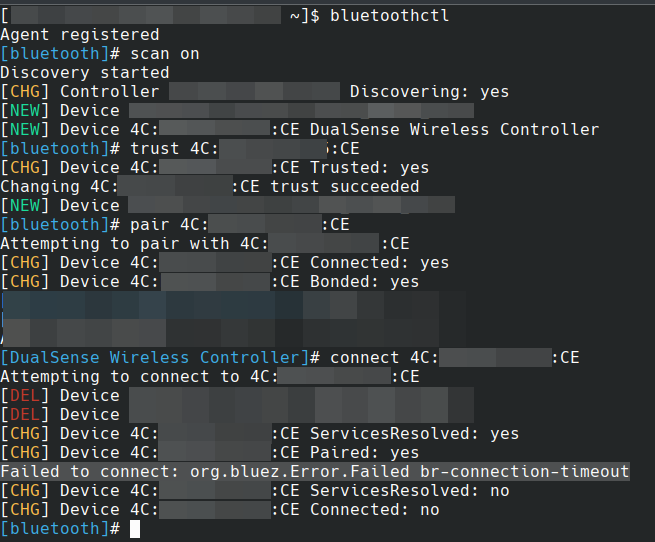

Here’s a screenshot of bluetoothctl connection status with the given error. It’s a simple timeout, I really have no clue of why it’s acting like that.
I have blurred any useless info, but the DualSense has the MAC that looks like 4C:[blurred]:CE. The bond works, but the connection fails.
I’ve tried many times to restart bluetooth.service, without success (same output every single time) manually and through the button popping in the GUI’s error popup.
