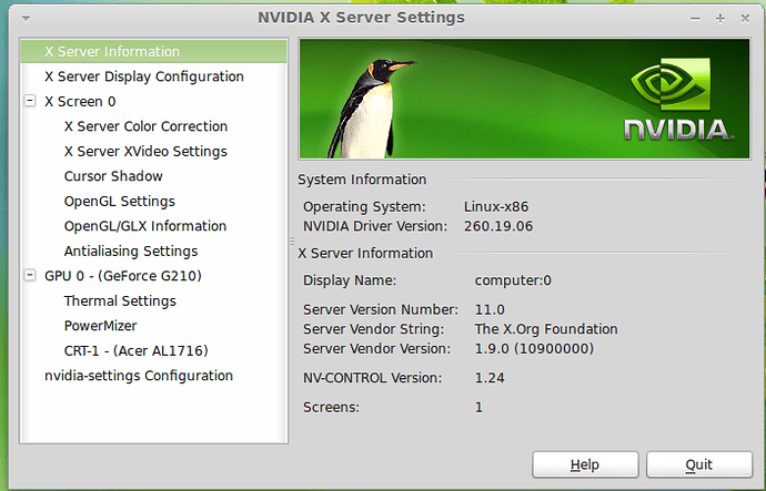

What if you do the configuration from nvidia-settings gui?
Yes, and drivers are installed, In nvidia x server settings I don’t see any option that i can change for fix this(for example resolution is correct)
