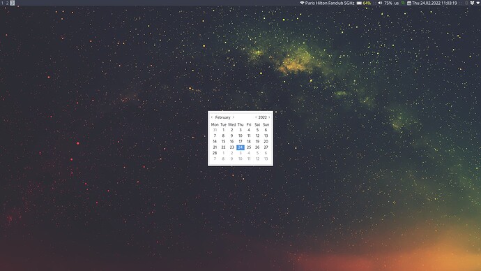

But when I click the block the popup is placed in the center of the screen, any advice on how I can troubleshoot this?
The popup calendar on my machine:
@morten_nissov You can comment out this line from your i3 config:
# set position of floating window
for_window [class=".*"] move position center
This is useful if you want to place all floating windows in center but in your case you can comment out those line and restart i3 inplace with Mod+shift+r.

Edit: And my calendar script is taken straight from the i3blocks-contrib repo I mentioned, here is the script:
#!/usr/bin/env sh
WIDTH=${WIDTH:-200}
HEIGHT=${HEIGHT:-200}
DATEFMT=${DATEFMT:-"+%a %d.%m.%Y %H:%M:%S"}
SHORTFMT=${SHORTFMT:-"+%H:%M:%S"}
OPTIND=1
while getopts ":f:W:H:" opt; do
    case $opt in
        f) DATEFMT="$OPTARG" ;;
        W) WIDTH="$OPTARG" ;;
        H) HEIGHT="$OPTARG" ;;
            echo "Invalid option: -$OPTARG" >&2
            exit 1
            echo "Option -$OPTARG requires an argument." >&2
            exit 1
    esac
done
case "$BLOCK_BUTTON" in
  1|2|3)
	# the position of the upper left corner of the popup
	posX=$(($BLOCK_X - $WIDTH / 2))
	posY=$(($BLOCK_Y - $HEIGHT))
	i3-msg -q "exec yad --calendar \
        --width=$WIDTH --height=$HEIGHT \
	    --undecorated --fixed \
	    --close-on-unfocus --no-buttons \
	    --posx=$posX --posy=$posY \
	    > /dev/null"
esac
echo "$LABEL$(date "$DATEFMT")"
echo "$LABEL$(date "$SHORTFMT")"

I assume you experience the same behavior with the same calendar script.
Did you ever get a chance to try the other calendar plugin?
