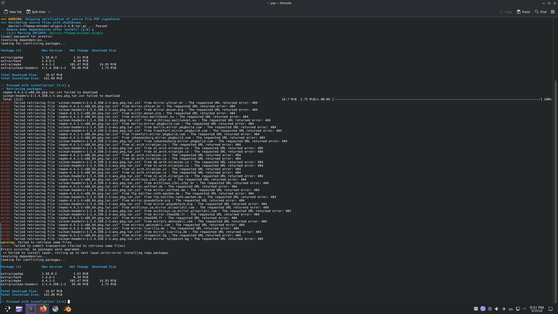

Trying to install davinci-ffmpeg-encoder-plugin using yay -S , i get the following error.
Tried updating my mirrorlist with reflector simple, checked every country, even the http mirrors, but to no avail.
Read somewhere that it might be a firewall/ ipv6 issue, but not sure about that, the errors people were getting where similar but not identical so i did not take any chances following any advice from other forums.
Any ideas?
First, please don’t post screenshots of text; post the raw data between the code tags. After updating the mirrors, you need to run yay -Syu instead of yay -S so your local databases will be updated.

Sorry for the screenshot, will keep that in mind.
Run yay -Syu and after the updates the installation worked like a charm.
