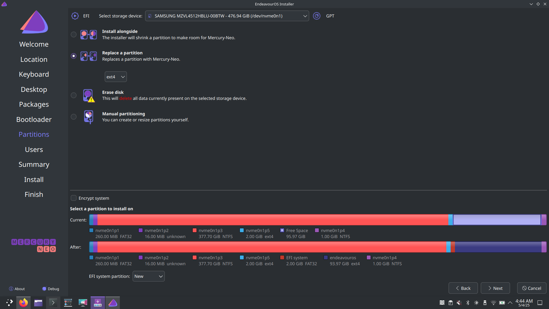

I’m trying to dual boot with Windows. I’m replacing a partition on which I previously had NixOs installed and then deleted that partition, and creating a new efi partition. But installation fails apparently when trying to create the new efi partition with this output :
https://termbin.com/2wth
Outputs for lsblk

So this one?
No other disks in play?
Ok.. there is an existing ESP at /dev/nvme0n1p1.
It is also populated with windoze stuff.
And its having trouble accessing it as it is read-only.
Considering you are trying to create a new ESP (at ~nvme0n1p6) I dont know why its even touching the existing one. But it does seem to be the cause of the issue.
Use Manual partitioning (instead of “Replace a partition”) and point the installer to the new ESP (2 GB FAT32) and the new EXT4 partitions you have created for EndeavourOS.
If you want to use Grub, you need to mount ESP at /boot/efi and flag it boot.
If you want to use systemd-boot you need to mount the ESP at /efi and flag it boot.
Edited to add that for your EXT4 partition you choose the mountpoint /. No flag is needed.

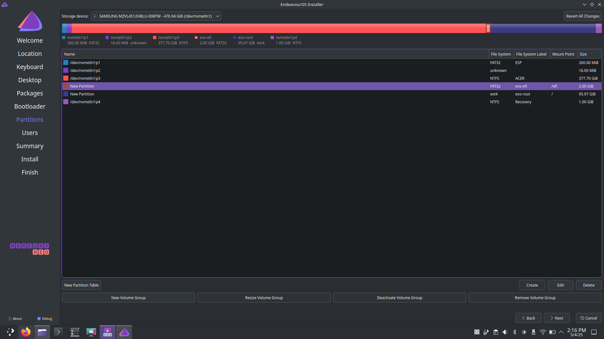

Tried manual partitioning, here’s what it looks like
Everything seemed good until about 80% installation after which i get this error
https://termbin.com/ics9 which looks like a calamares issue now

Try removing the esp/boot flag from the the first ESP (using partitionmanager or gparted).
You can set it back afterwards because Windows needs that for its updates/upgrades.
Then do as you did before in Manual mode. You could maybe try to let it reformat those partitions as well.
