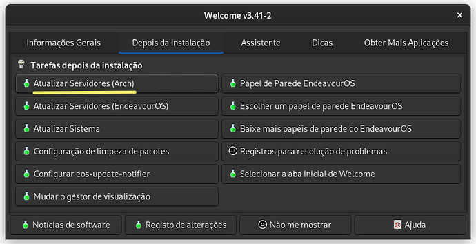

Screenshot from 2022-11-09 13-42-57
See: https://archlinux.org/mirrors/status/
You could perhaps use reflector-simple or the method of you choice to choose some other mirrors for now.
