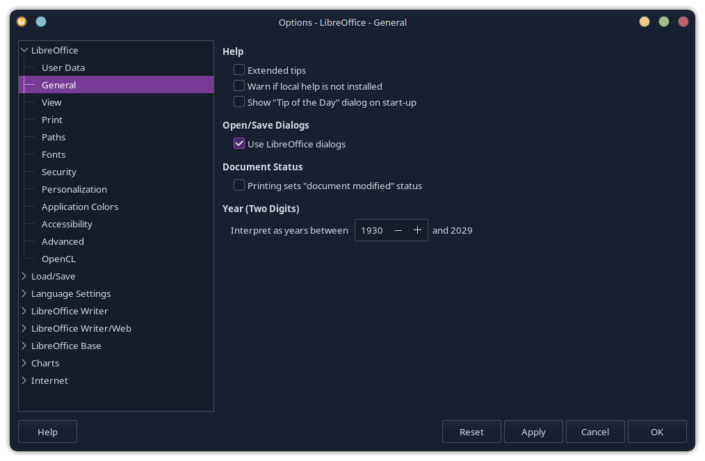

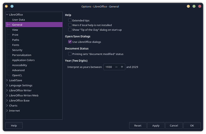

Hi @mizhimo and welcome to the forum. On Still I had to enable use LibreOffice Dialogs in the settings to be able to save. A few others have had similar issues.
Yep, this solved my issue. Thanks a lot.
It’s not actually solved, it’s a workaround. But either way, please mark @smokey’s answer as the solution. :wink:
