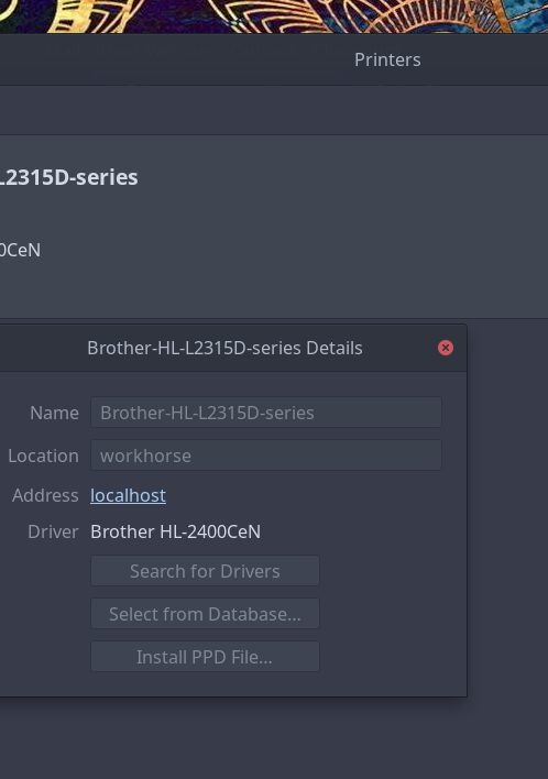

then go into endeavour (these are budgie’s actually) print settings and hand-choose your driver.
if it’s not there do what I did in pic: pick one close.
