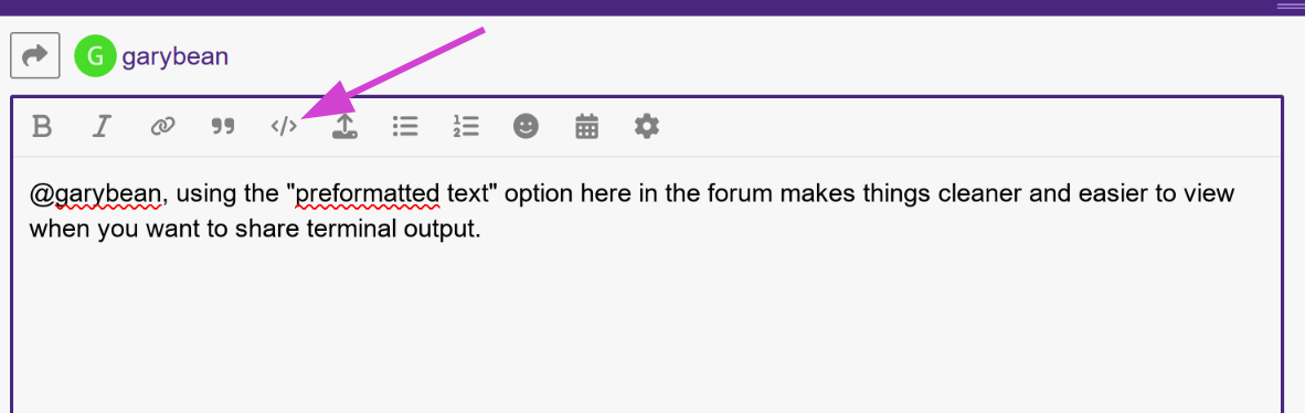

@garybean, using the “preformatted text” option here in the forum makes things cleaner and easier to view when you want to share terminal output.
It would look like this:
