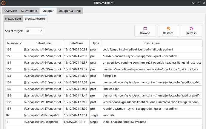

Hello,
Thanks for you help. I do this to create a predictable config I can restore to when something goes wrong in Ansible. As you can see, the snapshot shows up in Snapper and it is very ease to bring the system back to rollout state. I’m new to EndeavourOS and finetuning the Ansible playbooks from Fedora takes some time.
George
You could replace all this with(not tested):
snapper create -t single -d "Initial Snapshot Root Subvolume"
snapper -c home create -t single -d "Initial Snapshot Home Subvolume"
don’t overthink it, also you do not have to reboot after individual installations, just install everything, run all ur scripts, then reboot once.
