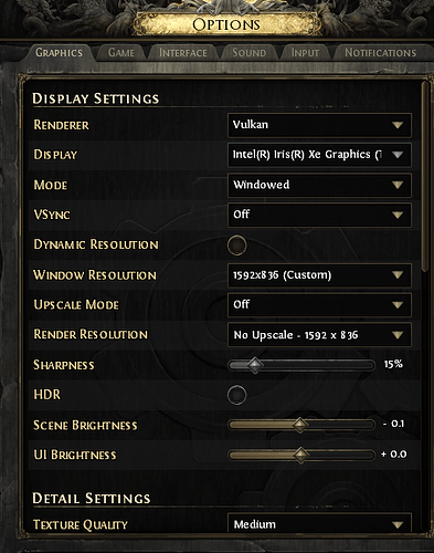

and that is what the game sees as graphic card - what is correct
the mtr to e.g. 8.8.8.8 shows me an average of 35 ms with no packet loss, but the game says with its own connection tool it is between 60 and 500 ms - crazy up and down of the ping and thus with the frame rate. Any tricks for me?

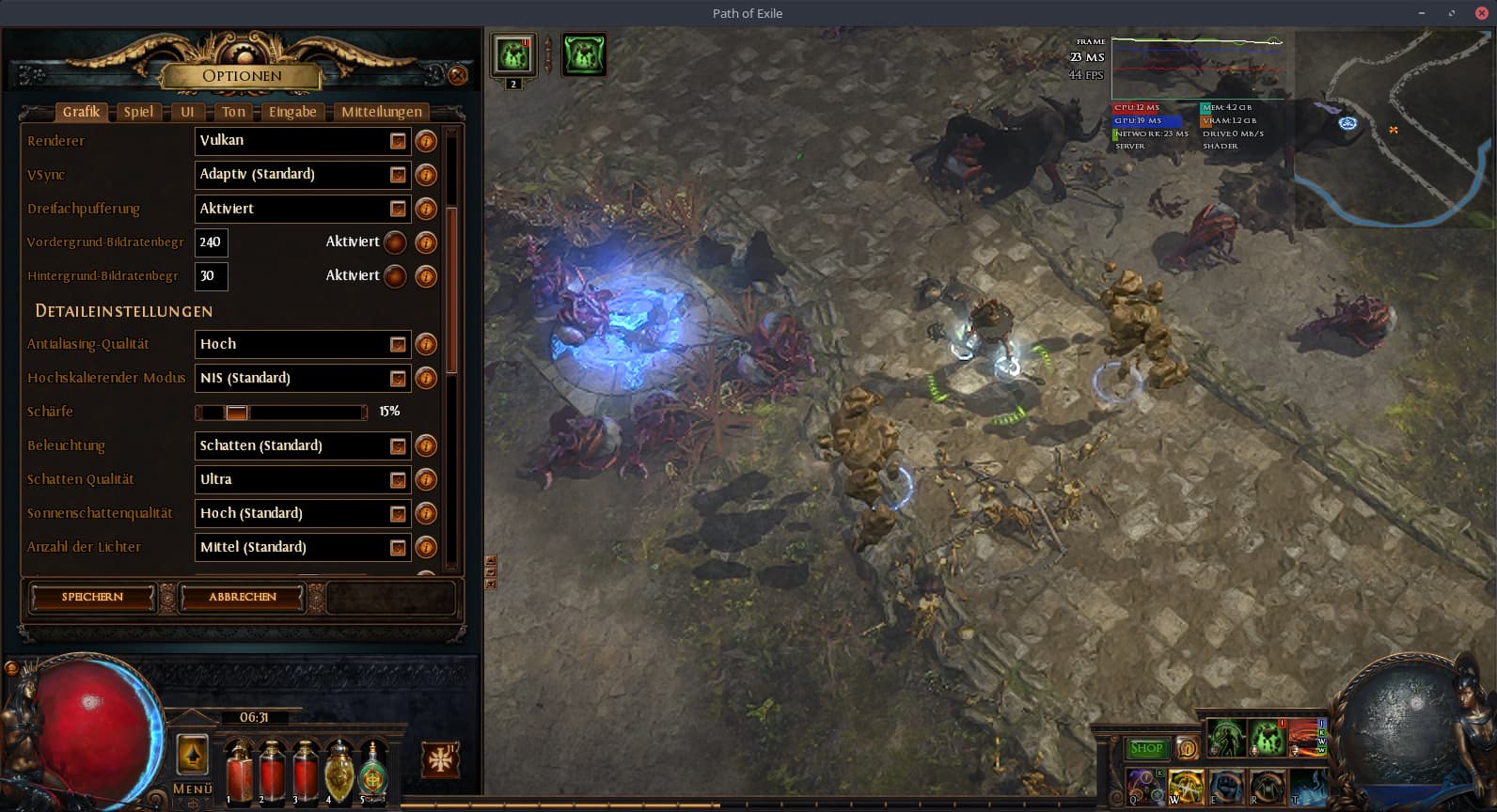

For to compare: This is POE1 with the same Laptop and settings high
