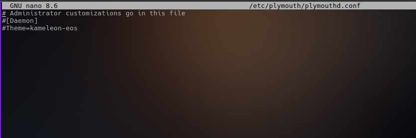

You should have removed the hashmarks from the 2nd and 3rd lines in plymouthd.conf

In case of grub you’d better insert splash in /etc/default/grub and run
grub-mkconfig -o /boot/grub/grub.cfg
