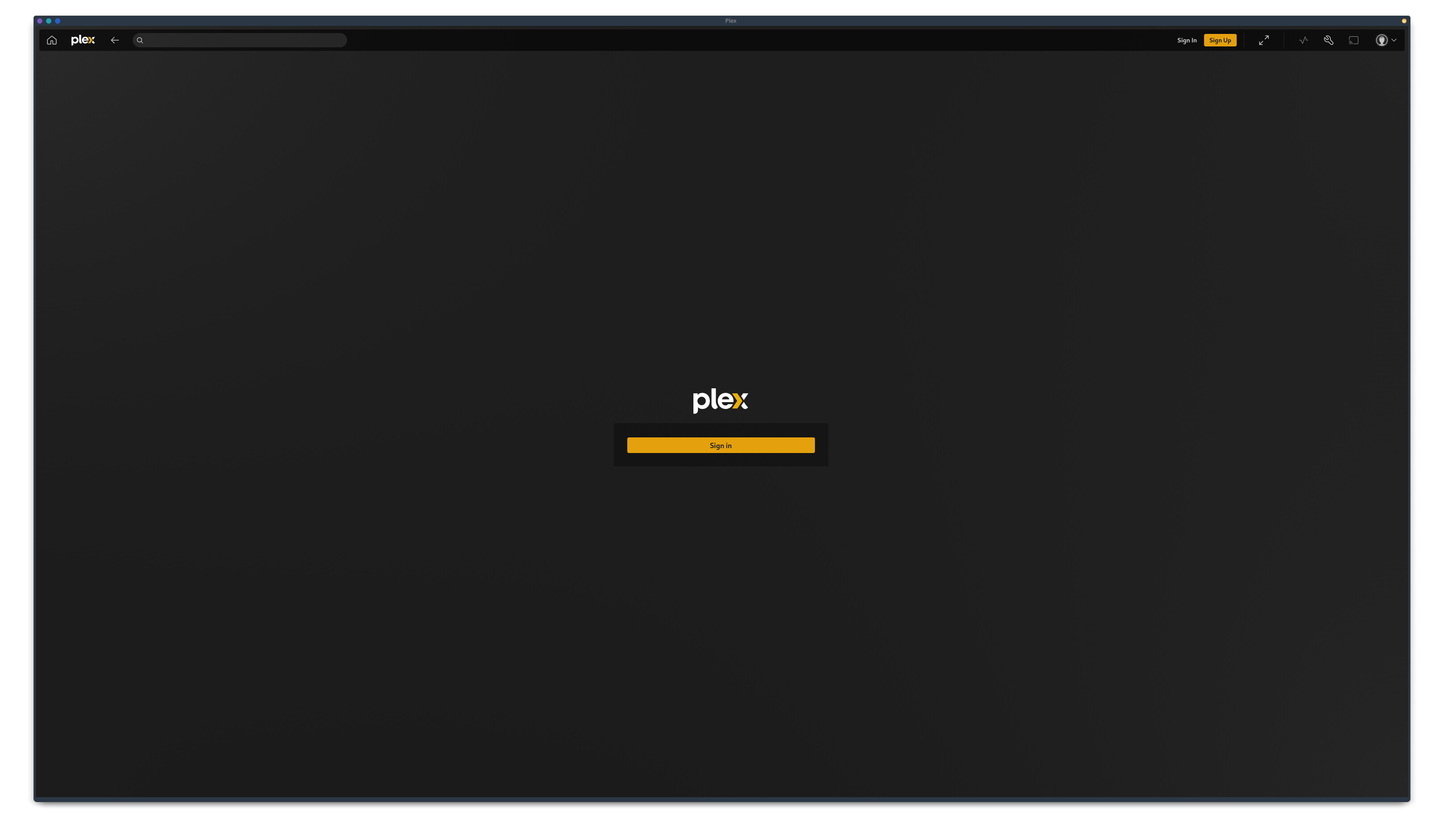

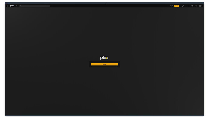

I recently installed plex-desktop from the AUR on Arch Linux, and I’m running into a strange issue that’s oddly familiar. It’s the exact same problem I had when I was using NixOS, but while I managed to fix it there, the same solution isn’t working on Arch, and I’m hoping someone here can help me figure out why and how to resolve it.
Here’s the issue: after installing plex-desktop from the AUR, everything seems fine until I click the “Sign In” button, nothing happens. No popup, no login window, just silence.

I tried the fix suggested in the AUR comments, but it doesn’t seem to work on Wayland. I believe another user has reported the same issue. This problem has persisted across most distros, even the Flatpak, for months now.
This is kind of strange. My daily driver is currently LinuxMint 22 and I have no issues running the Plex Desktop there – it allows me to sign in and plays media fine. I am currently testing EndeavorOS in a VM (thinking this might become my new daily driver) but I am experiencing what seems to be the same or a similar issue which you describe. And I am using X11 on that instance, not Wayland, so that would indicate it is not a Wayland issue.
When I click on the [Sign in] button, it responds by dimming slightly but does not bring up the sign-in page in my browser. Instead, after a few seconds, it displays a message “Plex is down for maintenance.” But, checking the status.plex.tv page it clearly is not in maintenance mode and I can go to the app on my LinuxMint native instance and can sign out and in there without issue.
On the other hand, in EndeavorOS, I can open a browser to my server directly (app.plex.tv) and am able to login there and play media. So, clearly something specifically wrong with the desktop client as built for Arch.
