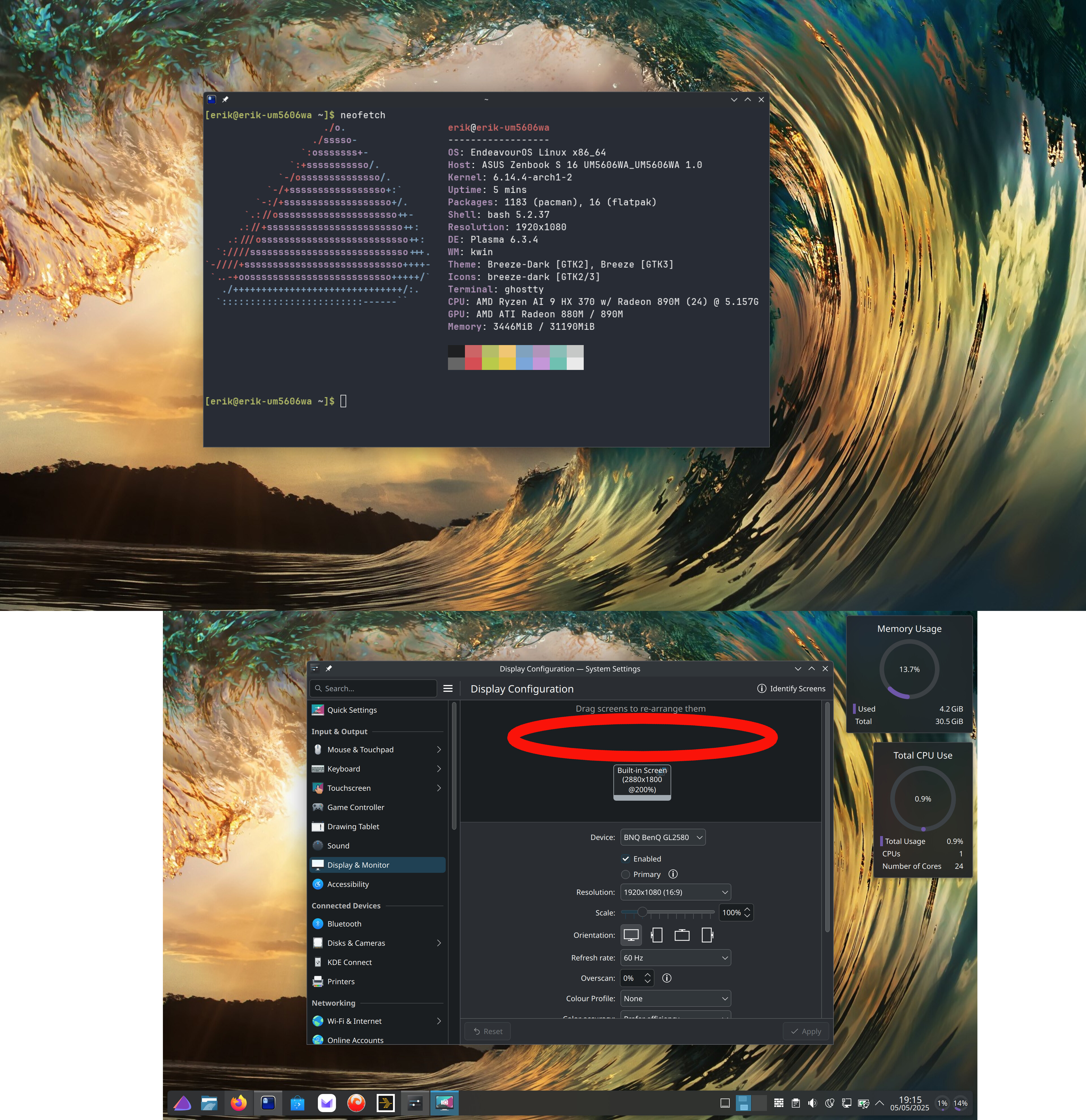

Another minor annoyance is that the part of the display configuration control where you drag screens to rearrange them, no longer shows the BenQ monitor at all (it used to).

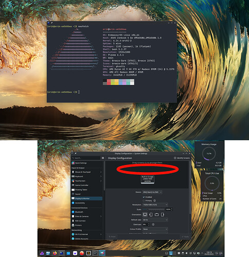

Below is a screenshot of my current config when it’s working, and a dump of inxi. With everything working, I can load up Steam and play games with no dropped frames (so AMDGPU is also working fine). Let me know if you have any advice on where to look or commands to use to try and fix this. I’d really rather not have to install Gnome just to get this working.
[Laptop]–TB4 cable–[Dock]–HDMI cable–[monitor]
