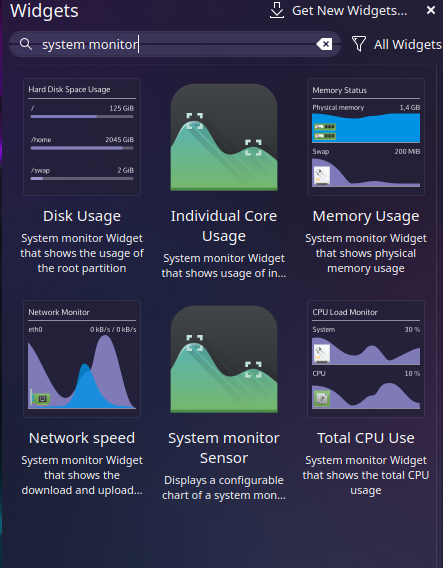

Which provided widget are you using? It doesn’t show under the name you provided and there are a few when I search for it that show up
The only extra widget I have on my system is the clock I use on the desktop with no issues so seeing if I can reproduce, if it is a third party widget please provide a link to it or show where I can get it so I know I am trying the right thing out
System Monitor Sensor.
Change from pie chart to application table in options.
